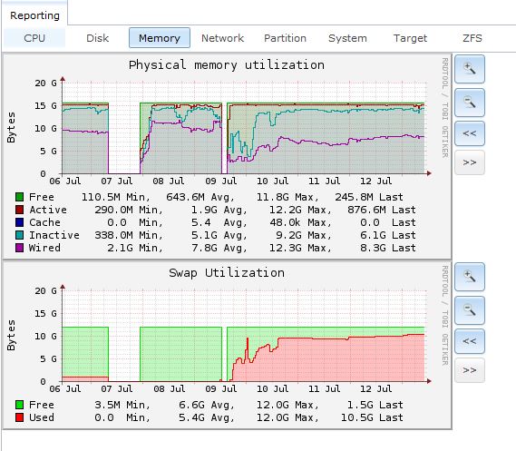

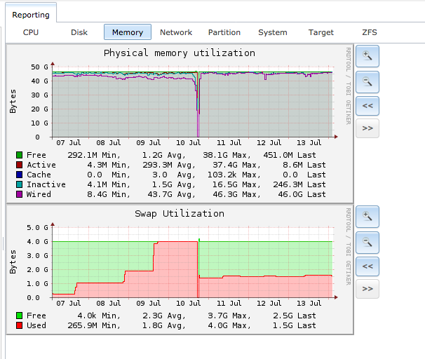

I logged into the FN11 webui to create a jail today, and noticed a *lot* of these entries.
I haven't seen them before, and have made no hardware changes in a couple of years.
I've attached a picture of the graph of my swap space as well, but it doesn't look like it was full unless I'm misreading.
Does anyone have any ideas?

You have something wrong with your system. Full hardware specs, what jails or vms do you have? What workflows?

OMG what are you doing! stop stop stop you can not run that many jails and a vm that has 16GB of memory.
eldo
Dec 18, 2014
99
Huh, I guess this is my first Danger Will Robinson moment.
I'd always understood that jail and vm memory was dynamically allocated based on load, etc, and since the VM was just sitting idle it wasn't being given to the vm.
What would be a good alternative? I've dropped the VM down to 4cpu and 4GB ram.

Just to give you some perspective this is what your memory utilization and swap should look like. This is my system, notice swap is zero and has never been more than zero. If you are ever using swap something is probably wrong. The alternative is to not use as many jails and vm's or get better hardware if you want to run this much stuff. You have a simple overuse problem.

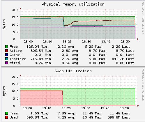

Ah, gotcha.
Unfortunately my reporting doesn't got back too far, but it was clearly next to nothing prior to the vm.
After cutting the ram in the vm, I'm sitting at < 600M of used swap. Ideally I'll be able to finagle seafile into a jail and then I can get rid of the VM completely, ending up wtih just 2 jails. seafile and everything else.
Thanks for the help, I've clearly got a *lot* more to learn about FreeBSD
ETA:
How would I go about determining what is currently using the swap since it's supposed to be unused?
Looks like it was exactly how it should have been after the upgrade to 11 and before I started playing with the first bhyve vm:

It's probably still the vm. I bet it will stay in swap until you reboot or maybe reboot the vm? I don't know enough about bhyve to know for sure.

The dropoff today was inclusive of the time the VM was powered off, and after power on with the new resource allocation.
Thanks again for your help, I was beginning to think I had some bad hardware juju coming my way and didn't want to deal with more than the pending doom of my avaton system considering both bugs that plague my board.
15,504

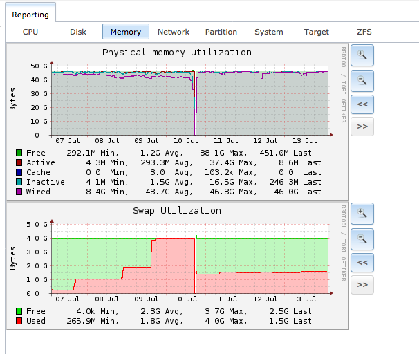

I'd tend to agree, but my FN11-U1 box (dual Xeon X5650, 48 GB RAM, one small VM to play with RancherOS, one plugin jail with Plex, which is disabled) is using significant amounts of swap (i.e., it's been close to maxing out the 4 GB of swap it has, and is currently using just under 2 GB), and being on the receiving end of a replication is bringing the machine to its knees. There's a lot wrong with what @eldo was/is doing, to be sure, but the fact that his system is using swap doesn't necessarily prove it.
SweetAndLow
Sweet'NASty
Nov 6, 2013
6,421
I think bhyve is messing with stuff and should be investigated more.
eldo
Dec 18, 2014
99
15,504
Out of curiosity, what changes did you make around July 7?
I'm not certain, but I think that's when I started using that box as a replication target for my main box.
pomah
Jul 30, 2012
55

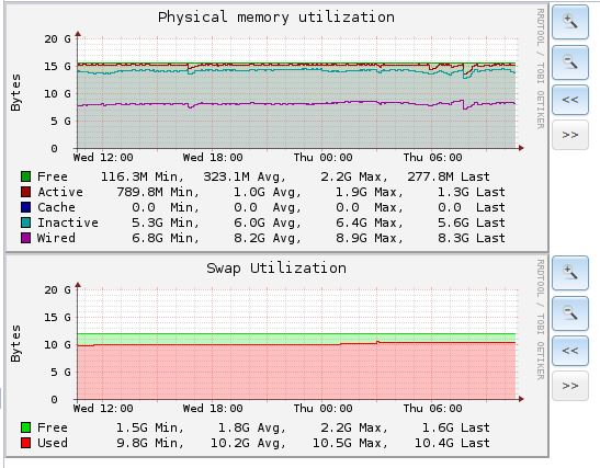

Hi any suggestions to what might be wrong?
I am running 3 services: smb, ssh and ups.
2 plugins: transmission and syncthing
That is it, 2 users, used as streaming for media and storing files in a home environment.
MrToddsFriends
Documentation Browser
Jan 12, 2015
1,338
Doubling the RAM would be a good idea. The minimum of 8GB RAM holds for situations where no plugins are used.
sam09
Mar 28, 2017
8
I'm having the same problem with swap utilization. I'm running the latest stable FreeNAS. My system specs (roughly, I'm out of town right now):
HPE Proliant ML10 Gen9
2-core Pentium G4400
16Gb memory (ECC)
3x3Tb HDD (mirror), 120Gb SSD, 1Tb USB external drive
No jails, no plugins. The system is used mostly as a network drive, very low utilization, using SMB and NFS services. There is also a Rancher VM running a basic web server and Nextcloud, again on very low usage. I used to run the VM with 6Gb allocated memory for a couple of months continuously without a problem, until I started getting these messages with failed swap space allocation. I disabled some non-critical containers and lowered the VM allocated memory to 4Gb about a week ago, which dropped swap utilization to about 2 out of 4Gb (quite precisely by 2Gb) and solved the problem. However the swap utilization started to ever so slowly creep up again and this morning I got a message about failed swap space allocations. As I'm out of town I can't check the exact trends right now.
I was going to order some more memory (upgrade from 16Gb to 40Gb) this weekend to get some machine learning models running on a VM, but this problem has me concerned. I read about a bug with SMB that can lead to increasing memory usage under certain conditions, but being far from a systems engineer I don't know if these are related or how I could investigate the issue further. At least the SMB memory bug should be fixed with the next release, but I'm a bit hesitant to make significant investments to extra memory before I have an idea what's going on. I thought I would check the memory usage of running processes once I get back and have access to my system again, but I'm not exactly sure how it should look as I've had no compelling reason to familiarize myself with the system until now (probably a mistake). So does anyone have any other suggestions of things I should check once I get back?
pomah
Jul 30, 2012
55
Well lets see how this goes, so far it has not stabilized, still goes up... can someone explain why the memory usage does that? Should it not load everything and be happy? Why does it ramp up, down and up again?
