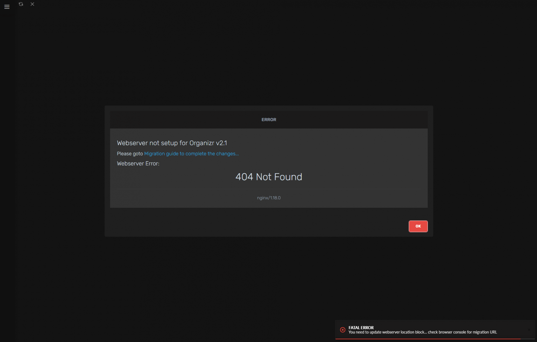

Benc
Nov 5, 2015
37
I accidentally interrupted organizr migration (2 - 2.1) process and now I can't access it. I tried reinstalling it but I always get same error page. There is also a link that should help, but I just don't understand it.
