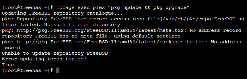

I followed the instructions to change the repo to get the latest for Plex and I get this error:
Any help is appreciated. Had it working yesterday then cleaned / re-installed jail to new location
htJwQH
This is normally and issue with networking not being setup correctly in the jail.
I have read that issue, not sure what would have or could have changed on the networking? If I tell the plex jail to ping pkg.freebsd.org then run update it works.

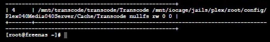

Using warden jails I was apple to map /mnt/media/transcode to /config/Plex Media Server/Cache/Transcode.
However iocage does not allow spaces in the path, how can I remap the transcode folder? I mounted this to /transcode and use the built in option to manually assign for use during transcoding, but there is not an option to change the Sync+ folder. I need to map to "/config/Plex Media Server/Cache/Transcode" so that Sync movies do not eat up storage on my apps SSD.

replace space by \040 when you add it iocage fstab -a JAIL /mnt/media/transcode /config/Plex\040Media\040Server/Cache/Transcode nullfs rw 0 0

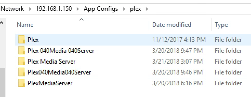

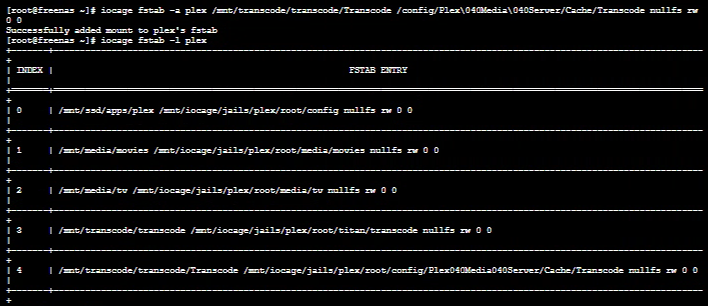

I have tried this too, puts 040 in the file path and creates the folder.
bigzaj
Jan 6, 2016
95
I put it in with the backlash, gets ignored everytime.
--SOLVED--
Thank you, in the fstab command I used two '\' this time so that it would show in the path, works now.
--SOLVED--
i have forget to write the " in the command iocage fstab -a JAIL "/mnt/media/transcode /config/Plex\040Media\040Server/Cache/Transcode nullfs rw 0 0"
