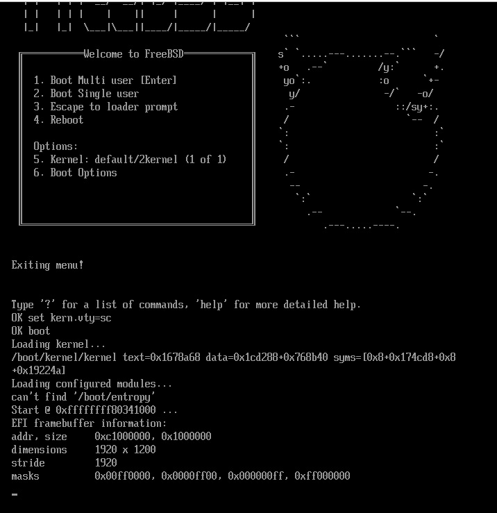

I see the boot screen the switch to black.
I found this trick in FreeBSD web idea about
Push 3 to Escape to loader prompt
type set kern.vty=sc
type boot
What I get see in attached jpg file as "can`t find `/boot/entropy`"
Anybody have idea what a hell that means? I don`t find a forum or web solution. Any other OS boot have same issue or just me?
KrisBee
Mar 20, 2017
1,288
Don't interrupt the normal boot process as seen via the VNC connection, when it reaches a blank screen switch to using a serial console connection and proceed to install if possible.
