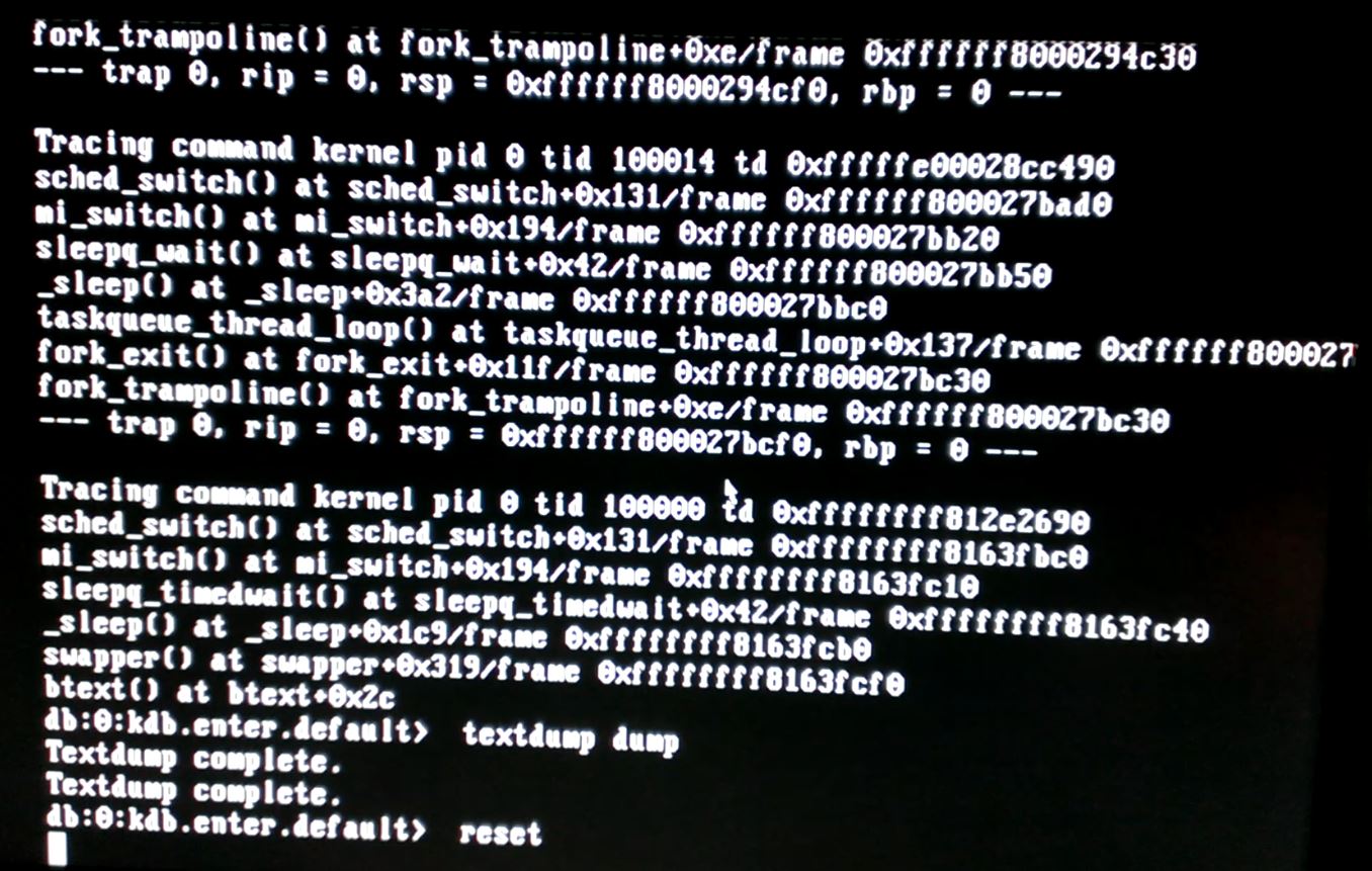

I have problems when transfering much files ~300gb for example, from one drive to another using my windows 8 Pro client. For the first half minute it looks very good with 50 MB Down and Upstream, then ALOT of messages appear on the server, i cant figure out what it is because there displaying too fast. then the server reboots. When i transfer files from client to nas there isnt any problem and the speed is ~90 MB tried with 900GB, works fine.

The copied data contains many big files as many little files as well, when it copies the big files it works just fine but then it copies the little files, the transfer speed decreases to some mb/s (normal behaviour it think). Then it decreases more and more finally to zero… this is the moment when the errors appear on the shell.
But theres more, every time after booting I get this “Freenas smbd[4850]: matchname failed on 192.168.2.2” where this ip address is the win 8 client. Additionaly I sometimes get this “unknown tag name 64” error.
I tried to disable the smart via bios but this hasn’t any effect.
Maybe Freenas isn’t compatible with this hard drive or my chipset, or maybe could it be a bug???
