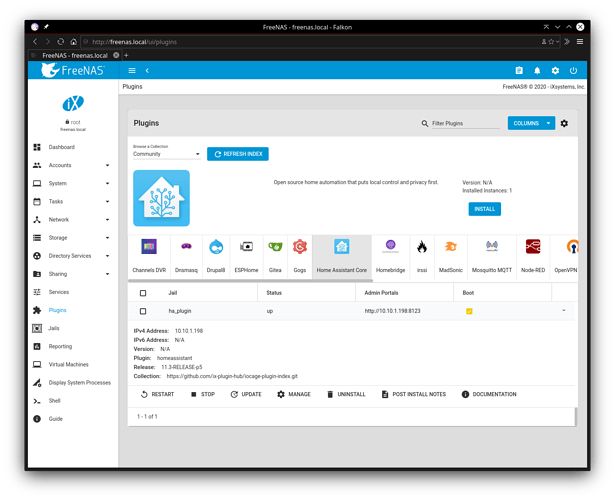

This will install Home Assistant Core. Basically, this is just a simple bash script to install HA in a virtualenv. This does not use docker. No you can not install plugins from the HA GUI. -- If you want to install the formerly known as Hass.io ( what ever they call it these days ) that allows installing plugins from HA you can follow this post in the Home Assistant Forums.
If you were using Hass.io, these would called Home Assistant Plugins and they would be managed from within Home Assistant -- To be clear this is not Hass.io -- If your on FreeNAS 11.3, check the community plugins. There are a few common things available that you would find in Hass.io -- In this case these are referred to as FreeNAS plugins and they are managed from FreeNAS.
