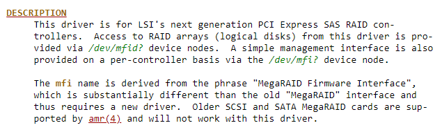

ok thanks for the reply I was going thru the rules a little at a time. but the the mfi is this
HARDWARE
The mfi driver supports the following hardware:
+o LSI MegaRAID SAS 1078
+o LSI MegaRAID SAS 8408E
+o LSI MegaRAID SAS 8480E
+o LSI MegaRAID SAS 9260
+o Dell PERC5
+o Dell PERC6
+o IBM ServeRAID M5015 SAS/SATA
+o IBM ServeRAID-MR10i
+o Intel RAID Controller SROMBSAS18E
https://www.freebsd.org/cgi/man.cgi?query=mfi&sektion=4&manpath=FreeBSD+9.1-RELEASE
so thats where I was getting that it was supported, I will look more into the manual more now. Thanks
