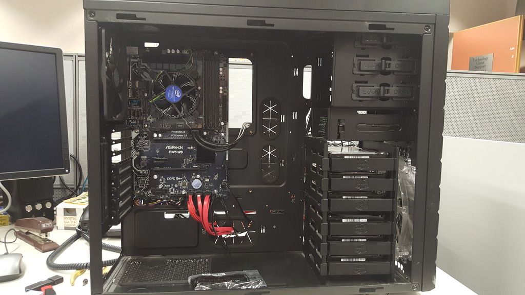

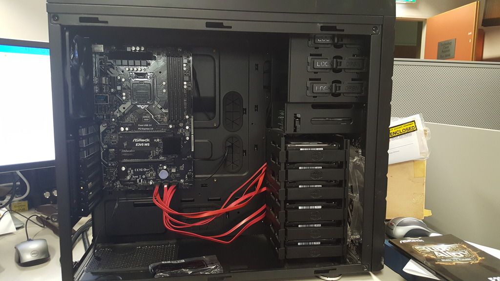

And the build begins.
Still have to buy the cpu and ram.
Nice case :) I'm using either the same or a variation of the same case in my FreeNAS build, also a "leftover" from a prior build.
