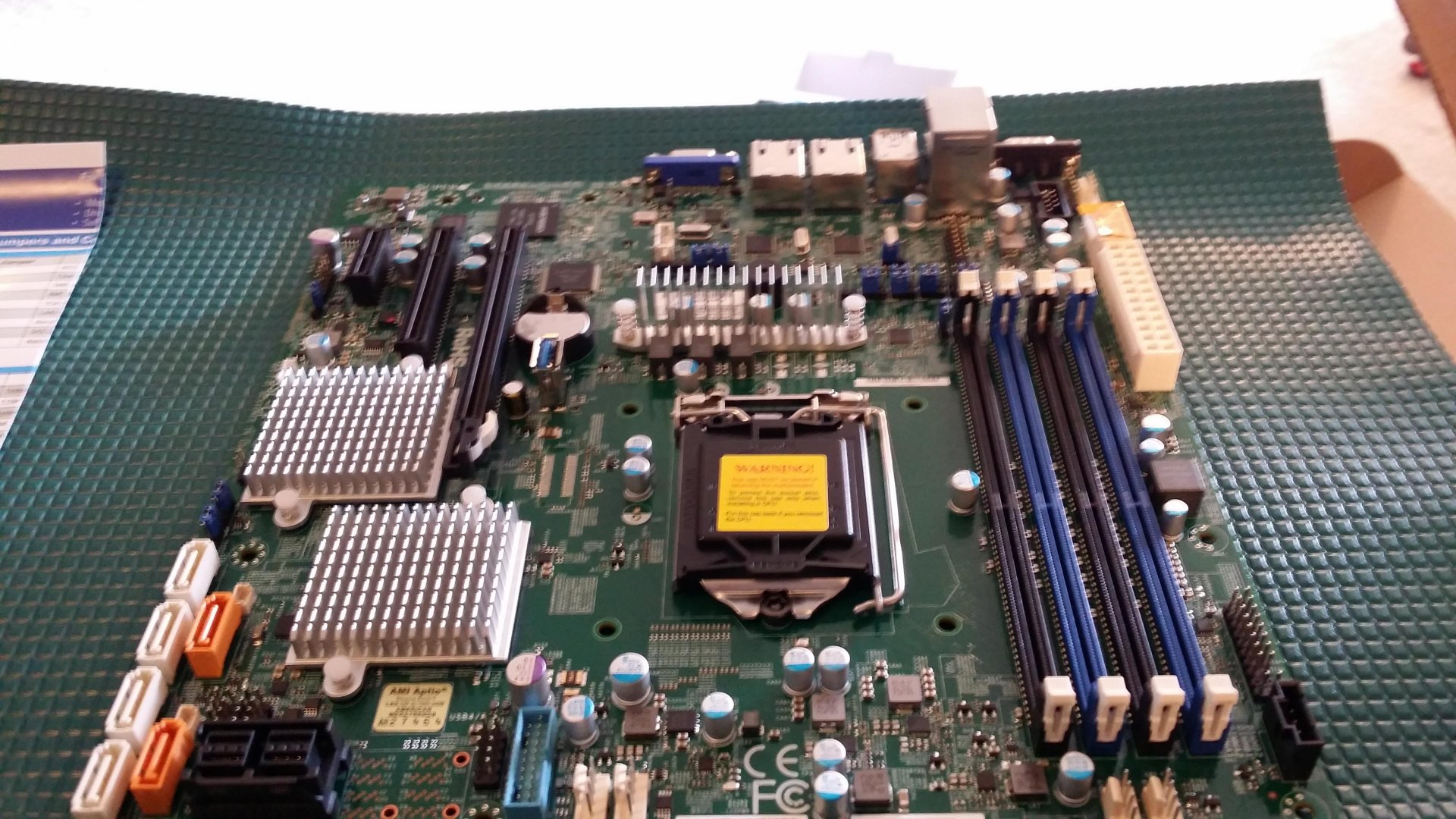

CPU: Intel Xeon E3-1230 V5

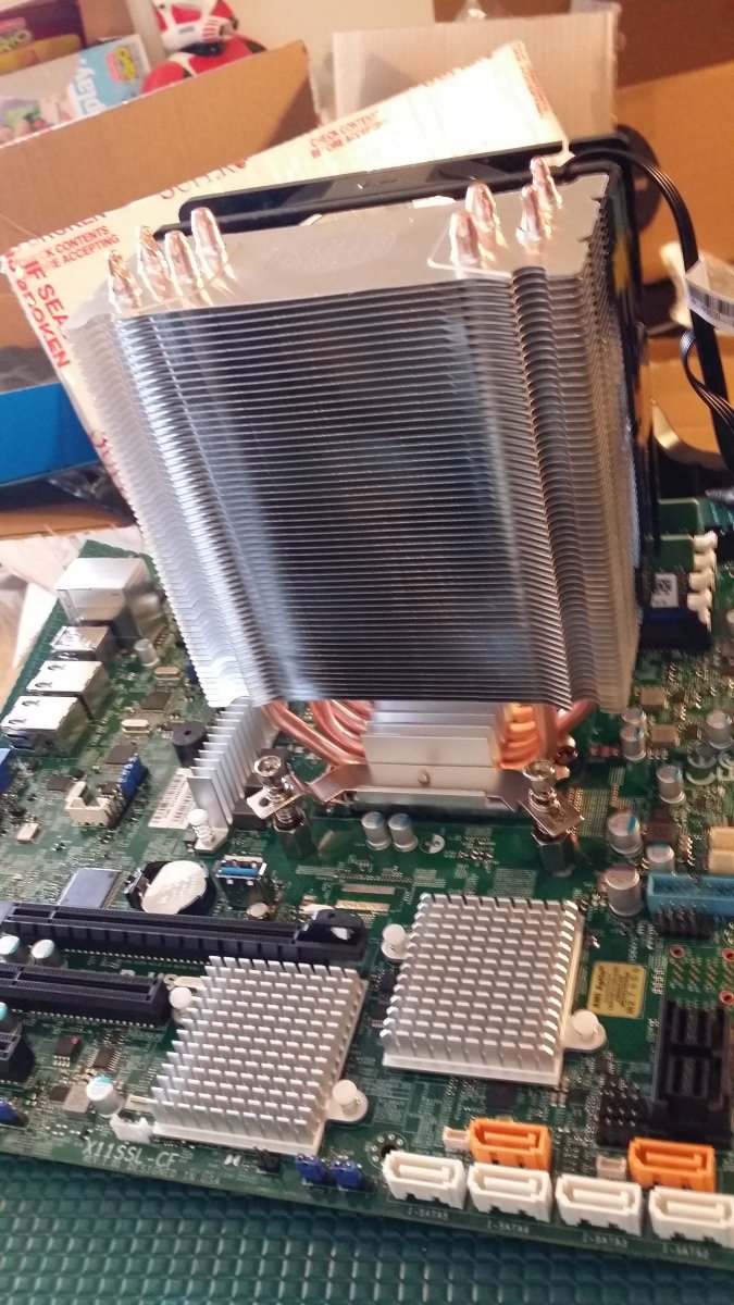

CPU Cooler: Cooler Master Hyper 212 EVO
Mobo: Supermicro X11SSL-CF
Memory: Crucial (2 x 16 GB) DDR-2133

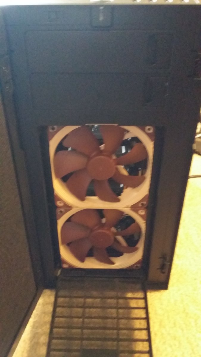

Fans: 2 Noctua NF-A14 FLX 140mm Fans

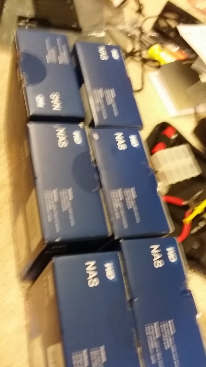

Also purchased 6 + 1 Cold Spare 3TB WD Reds.

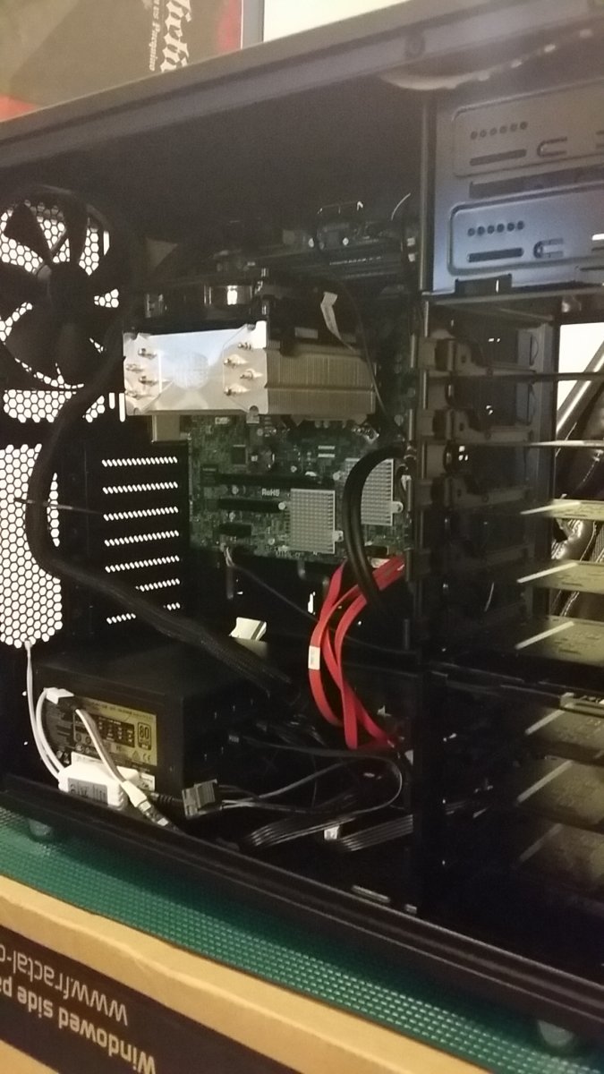

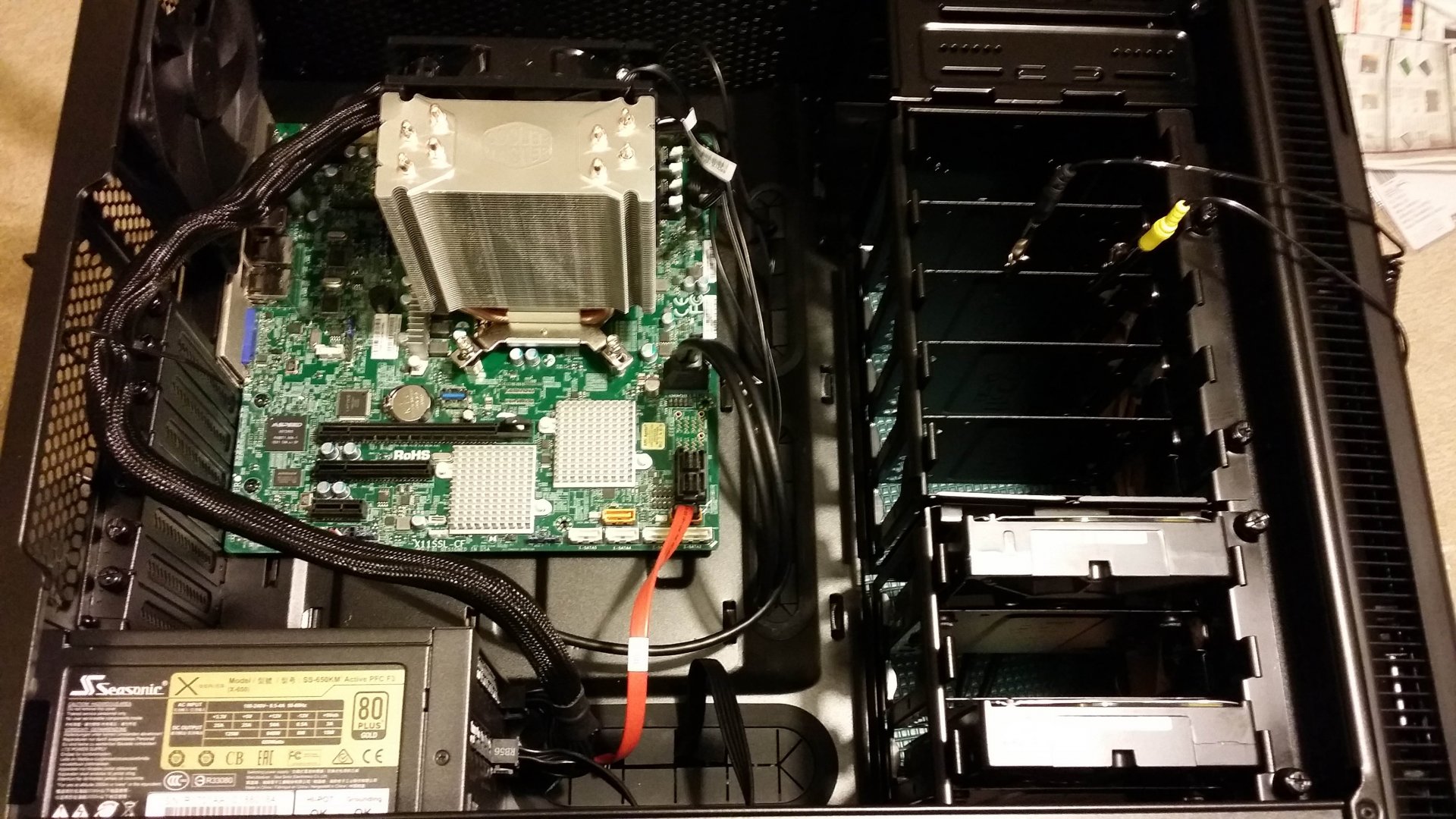

I put the hardware together:
and had a successful POST.

I followed qwertymodo's
"How To" on Hard Drive Burn in. Conveyance, short, long, badblocks (50+ hours), long.
All drives passed.

The GUI showed a warning for a mismatch for my LSI 3008 controller firmware/driver. I had seen the issue of the version on the driver/firmware being offset, but for me (Supermicro X11SSL-CF mobo w/ the LSI 3008) the firmware version and driver version were both 12. Had to flash the firmware, took some reading and researching to figure out what to do. DL'd the firmware from supermicro HERE and THIS youtube video was very helpful in actually flashing the firmware (be sure to go "into" the USB stick or change to the USB stick so you get the fs0 prompt and THEN kick it off). I did not the first time and it cleared out the firmware but could not open the install files on the usb stick. Once I got in there, it found it and installed no problem.

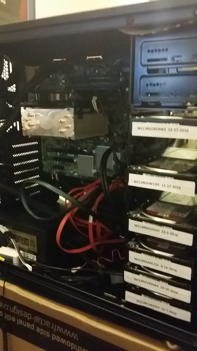

I know there is much debate about the position of that kind of CPU cooler. Might I suggest you put the fan on the bottom of the radiator to push the hot air UP.
wblock
Documentation Engineer
Nov 14, 2014
1,506
Agreed, that will also help move the heat from the two small heatsinks on the motherboard out.
It's easy to do, since the fan on the Evo just clips onto the fins.
I'll flip it around next shutdown.
