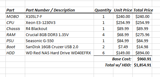

Ok so this is an updated build list. My thinking with the X10SL7-F and the Xeon E3-1230V3 (now a E3-1231V3?) is because of PLEX and wanting to build for the future, as in ensure I have enough CPU power for multiple streams of transcoding. This is what I've come up with through reading the forums here. How does this look to you guys? I'm not terribly concerned with cost, but that is why I went with 6x WD RED 4TB drives instead of the 6TB.
The big question I have is because I'm really mainly concerned with PLEX transcoding, is the Xeon E3-1230 the best way to go? Or will the G3220 or i3-4330 serve me well? After reading through Cyberjocks guide it seems the best way to go will be the E3-1230.
Thanks again for all the help.
Depends on the amount and quality of the streams. For light-to-moderate use, an i3 is generally acceptable.
Thanks for the help Ericloewe. I think I will stick with the above mentioned parts lists and use that build, assuming that it looks like a legitimate build. From what you guys have said in this thread and what others have said in other threads, I think this will be a good quality build.
