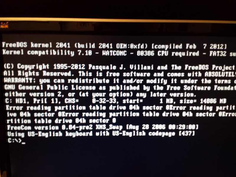

Well gpsguy, not sure if you can help, but I am stuck. I was struggling with bringing up a shell to start the process. I followed the directions from another post on FN. Here is the post, and my error message:

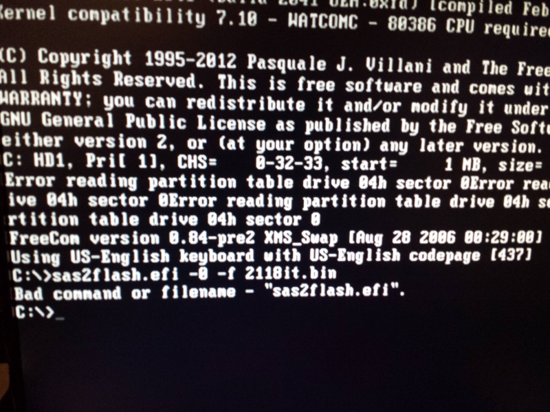

So, I can make it to number 9, but then it says bad command or filename. There was a message above that says: Error reading partition table drive 04h sector 0 from the start. The "o" being zero's. I hate not knowing what I am doing with this. I am assuming that I successfully cleared the old firmware in steps 4-6. So, I successfully disabled my card :). Steps 4-5 successfully put the chip in FUSION mode, and said "success". Next in step 6, I successfully erased flash chip. Didn't know the command prompt for reboot, so I CTRL+ALT+DELETE. After reboot, I was taken right back to where I was. This is where I am stuck. I am assuming the "o" is a zero. Not sure what to do next.

You can't use the EFI tool in DOS. Use the DOS flash tool or boot to an EFI command line.

So, abandon this guide all together? Which DOS flash tool? Do I use the same commands with the same files that I have on my usb stick? Again, sorry I don't know what I am doing.
jgreco
Resident Grinch
May 29, 2011
18,680
sas2flsh.exe is the DOS tool. Use that instead of sas2flash.efi if you're going that route.
