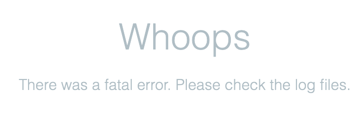

But even so, I'm getting this when I browse to the jail:
More to follow.

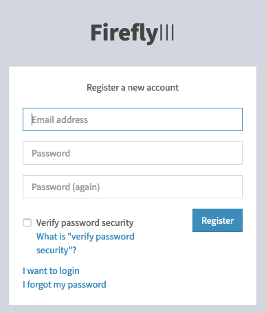

Edit: these commands need to be run before browsing to the jail:
php artisan migrate:refresh --seed
php artisan firefly-iii:upgrade-database
php artisan passport:install
After running them and browsing to the jail's IP address, I now get this:
Looks like a successful installation.
