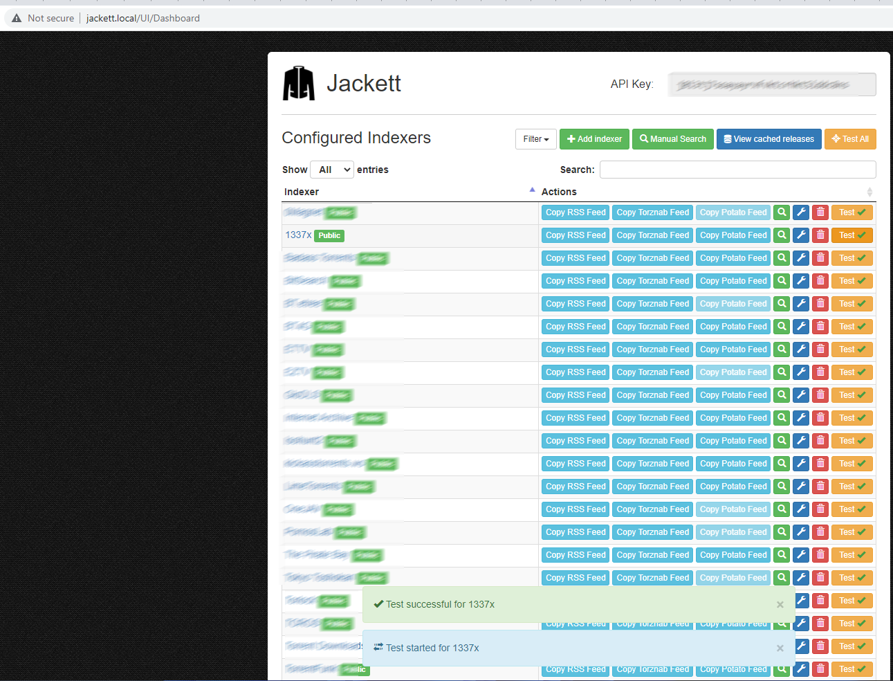

Regardind 1337x, in my case it is working:
