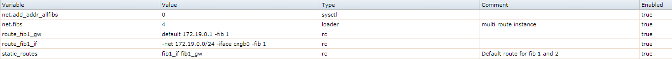

I have created multiple fibs to split my management network from my user and jails area on freenas.
For internet access this works just fine jail and the base freenas can ping the internet and get file etc. The problem comes in when I attempt to send traffic from a device on the management network to an iocage jail on the jails area with a non default fib. (Note: sending traffic from the jail works and I can ping properly out the fib through the router and to my box on management net)
See attached pic for the fib tunables setup (Note: having net.add_addr_allfibs as a loader type used to work for warden jails in 9.3, but now makes it so even the jails cant reach out to management net, setting as sysctl type got the jails to connect to management net)
