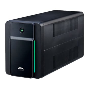

Thanks too @artlessknave for your tip against Cyberpower. A little more googling has made me wary of them. Will this do?
APC 1600VA 900W Line-Interactive UPS
