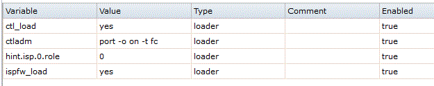

I'm not exactly sure why it didn't work. ESX no longer saw the FC target that had a VMFS filestore on it. I set the tunables and init tasks as mentioned in the above post:
I changed to FreeNAS-9.3-Nightlies and updated the system. After the reboot, ESX could see the FC target again. Not sure if something was hung up or some update in the nightlies fixed it.

Maybe it is all obvious, but, did you configure again all the tunables to make the FC work?
For me sounds like the configuration was lost ... Re-doing again the configuration (or even delete them to re-write again) sounds the first thing to do.
