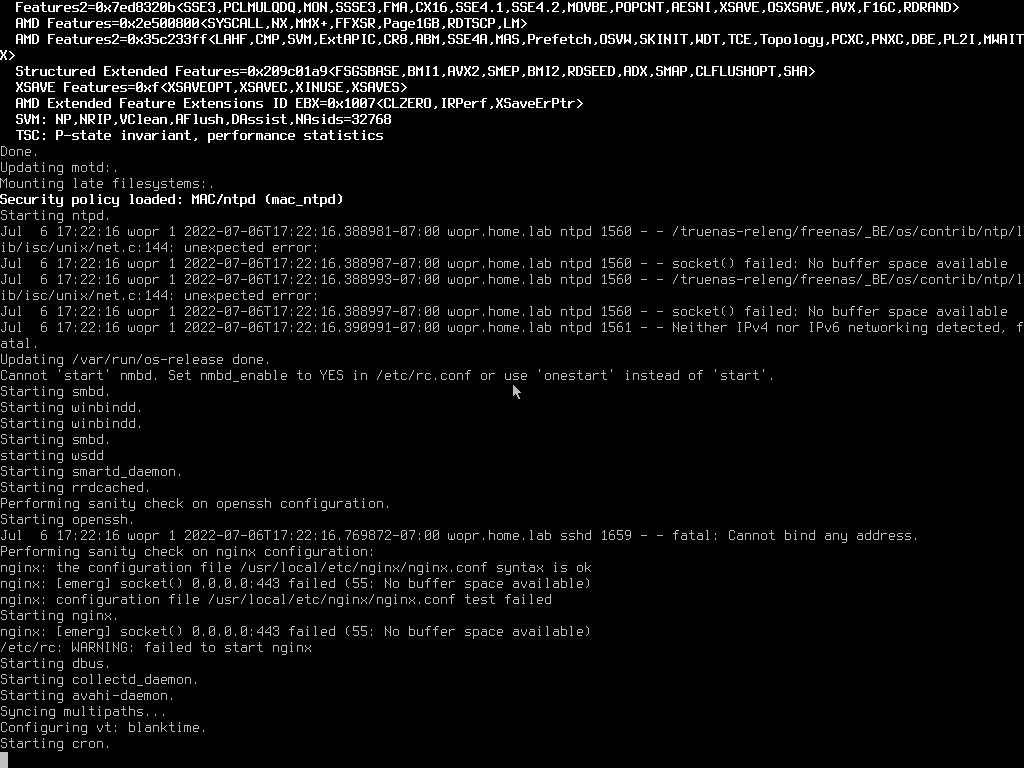

I added some tunables and may have fat fingered something because after reboot, some critical function seems to have gone sideways, most notably SSH, HTTP and SMB are not functioning. The server pings and I can get console access through the IPMI. What I see from the boot messages is that the web server, ssh, etc. are failing due to "no buffer space available" (probably because I put something in the tunables that I shouldn't have!).
These are the tunables I applied:
net.inet.tcp.recvspace= 4194304
net.inet.tcp.sendbuf_inc = 2097152
net.inet.tcp.sendbuf_max = 16777216
net.inet.tcp.sendspace = 4194304
net.isr.bindthreads = 1
net.isr.maxthreads = -1
Maybe I added too many buffers?
I also made some changes to the SMB conf on the shares but I don't think that would be blowing everything out of the water like this.
Question is how do I reverse the above tunables from the shell (without the web UI)?

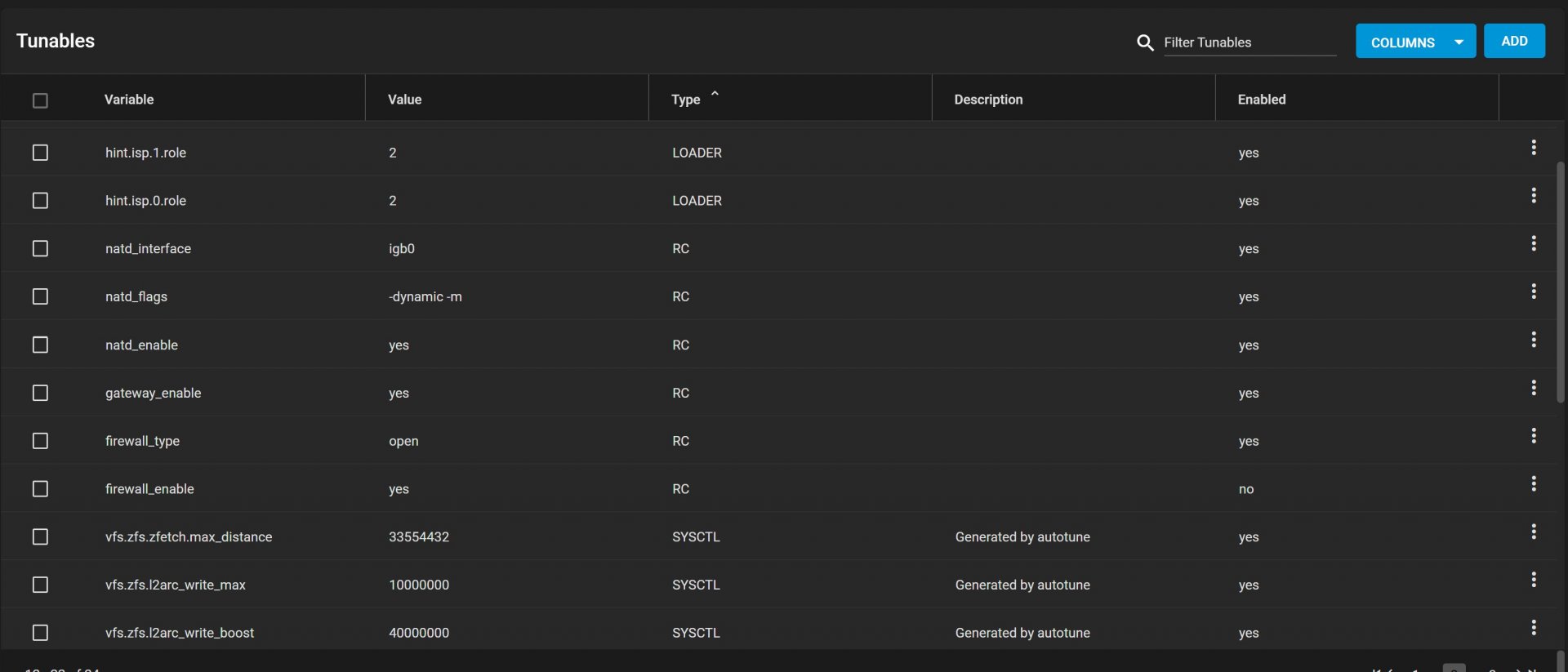

Thanks @Samuel Tai, have autotune enabled already.
I disabled all of the RC tunables I had created and enabled them one at a time (rebooting between changes). Turns out the one that was causing the problem is "firewall_enable" -> "yes"
Any idea why this would break my login from a local host (not via open vpn)?
Samuel Tai
Apr 24, 2020
5,399
TrueNAS is not intended to have the firewall enabled. By default, the firewall blocks ALL traffic on ALL interfaces. You'd need to enable ALL the ports needed for TrueNAS on the interfaces you expect to use if you enable the firewall.
