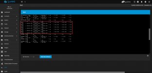

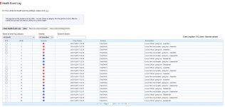

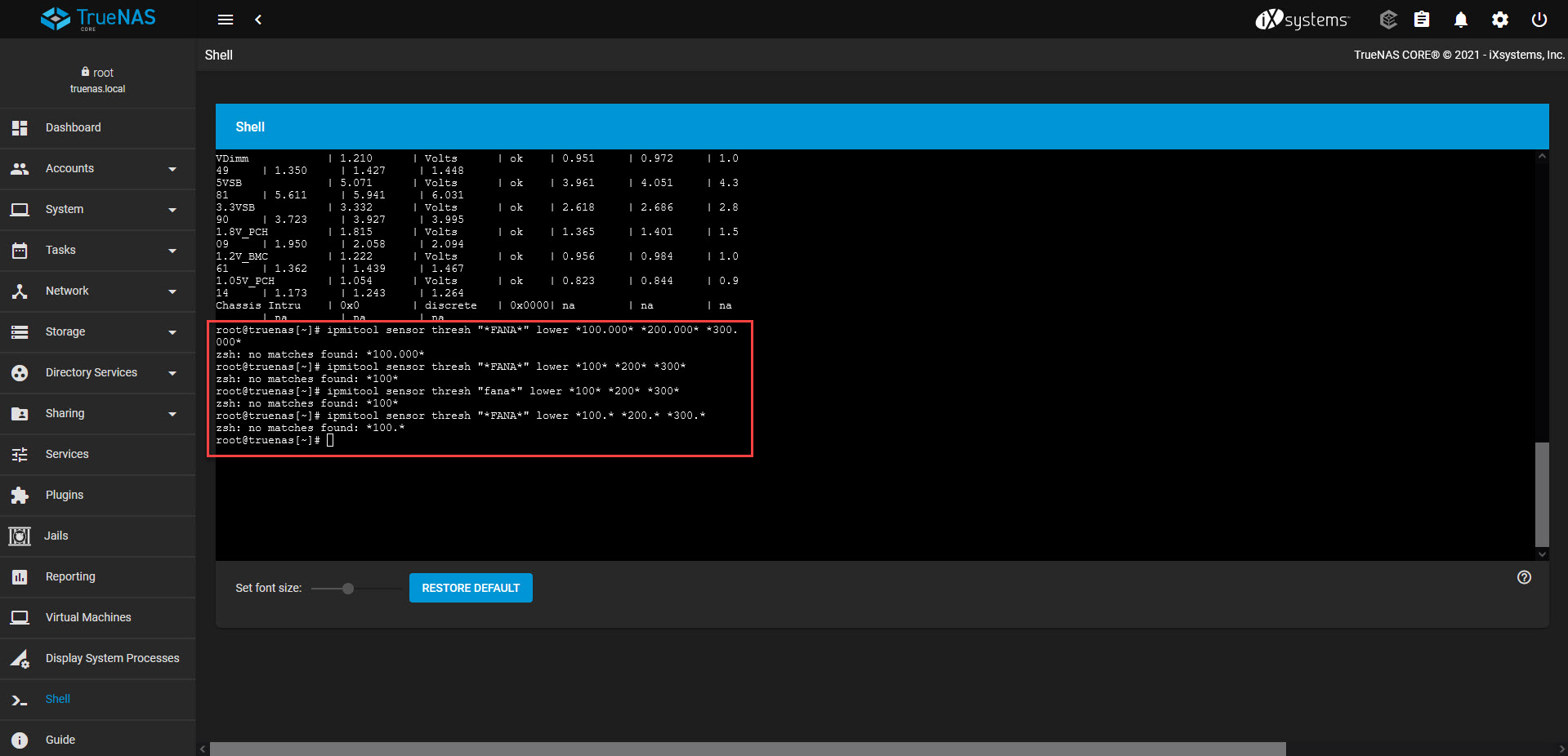

Would like your help with the following.
I am unable to get the fan speed (noctua) adjusted via the commands in truenas shell environment.
See pictures.
To avoid reports they are now running at full speed.

I belive the command is this, "ipmitool sensor thresh FANA lower" then your numbers..
so try this
ipmitool sensor thresh FANA lower 100 200 300
K.J
Apr 3, 2021
84
so try this
@shamo316 Thanks, it works.
I started from an old tread from: @Ericloewe
