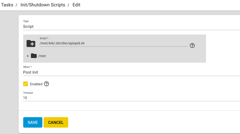

@nasnice and others having proplems starting this as post-init script:
The post-init scripts want a timeout setting, so you have to start a script to start your script.:smile:
I did something like this:
#!/bin/bash
/path/to/your/spinpid2.sh &
Save as start_spinpid2.sh and then use this as the post-init script. I set the timeout for this to 30 sec in the gui but I think less will do.
Glorious1
Nov 23, 2014
1,211
I haven't found it necessary to create another script to start the script. My postinit task looks like this:
Glorious1
Nov 23, 2014
1,211
Interesting. Didn't get it to work this way...
Maybe related to permissions? My permissions (755) of the containing directory:
drwxr-xr-x 2 jim wheel 14B Sep 9 08:04 bin/
and the script itself:
-rwxr-xr-x 1 jim wheel 16K Jun 16 15:14 spinpid.sh
D-7
Apr 8, 2017
14
All files look like this:
-rwxrwx---+  1 d-7  d-7   21535 Aug 20 19:44 spinpid2.sh
Well, I didn't invest too much time in this. Just tried two times and also with "timeout = 0" to eventuellay skip the timeout. Didn't work so I wrote this "wrapper script" which worked instantly and then I forgot about it. :wink:
