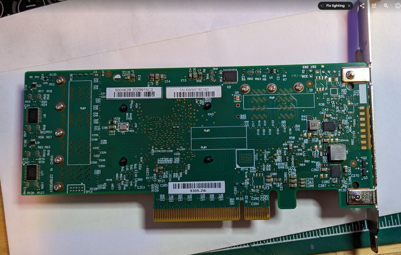

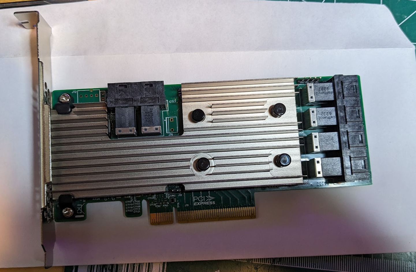

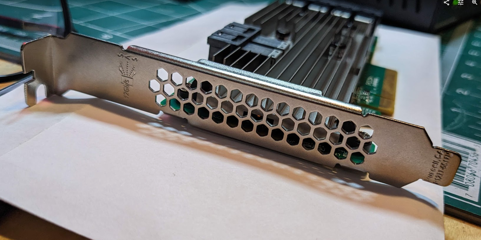

Here is my 9305-24i card I bought off a seller in China in Feb 22. Had the card in a machine for about 1 year but hadn't used it as I was still using netapp jbods. Anyhow went to migrate the disks to this card and realized it is not functioning properly. Does this look like a fake?

It's hard (at least for me) to tell, most of the time I look at a legit card for A/B comparisons. Noted on your card: missing LSI logo (or Avago/Broadcom) on the PCB, barcode stickers on the back are fishy looking - especially the "9305-24i". All of the stickers feel rather unbusy whereas they are typically info-dense on legit cards. Missing any declaration of conformity stickers (the weird "FCC" sticker for US class B, CE, etc). Other presumed-legit examples of the 9305-24i seem to have labels on each of the SFF ports. You might want to see if you can find good pictures of other known-sourced-from-Broadcom cards and look for telltales.

Yes. Unfortunately it is really hard to find real images of this card online. I did research it before I bought it and even called broadcom. They didn't have the serial for it on file but could not rule it a fake as there were possibilities in play where they might not have the serial. The card died over the course of a year. It was plugged into an active system but not actually used. I felt the same way about the stickers initially but all the samples I could find at the time looked similar.
