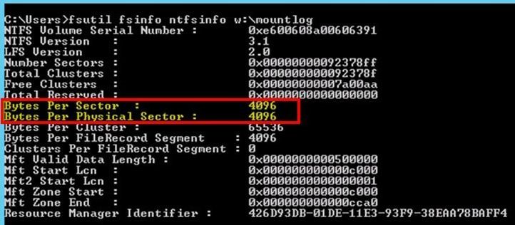

The solution consists of forcing Windows to fake 4k sectors when reporting to applications (Win10 emulation within a W11 file driver core). This requires a registry change and reboot...which doesn't work. I've PowerShelled the command in, checked it, it's there. Rebooted. Many times. And that's where I am currently stuck. The MS article suggests that the physical sector value (which remains 64k) is no longer relevant when the "ForcedPhysicalSectorSizeInBytes" value is specified (see screenshot 1), even if FSutil still sees it as 64k (see screenshot 2).
However the SQL error persists, indicating that the initial physical sector size maintains some relevance in the SQL scheme of things.
The command confirmed in the registry:
FSUTIL still reports 64k physical bytes per sector, but changes the "effective physical bytes per sector" to a 4k sector size-presumably the result of the emulator layer.
Does anyone have experience with resolving this issue?
