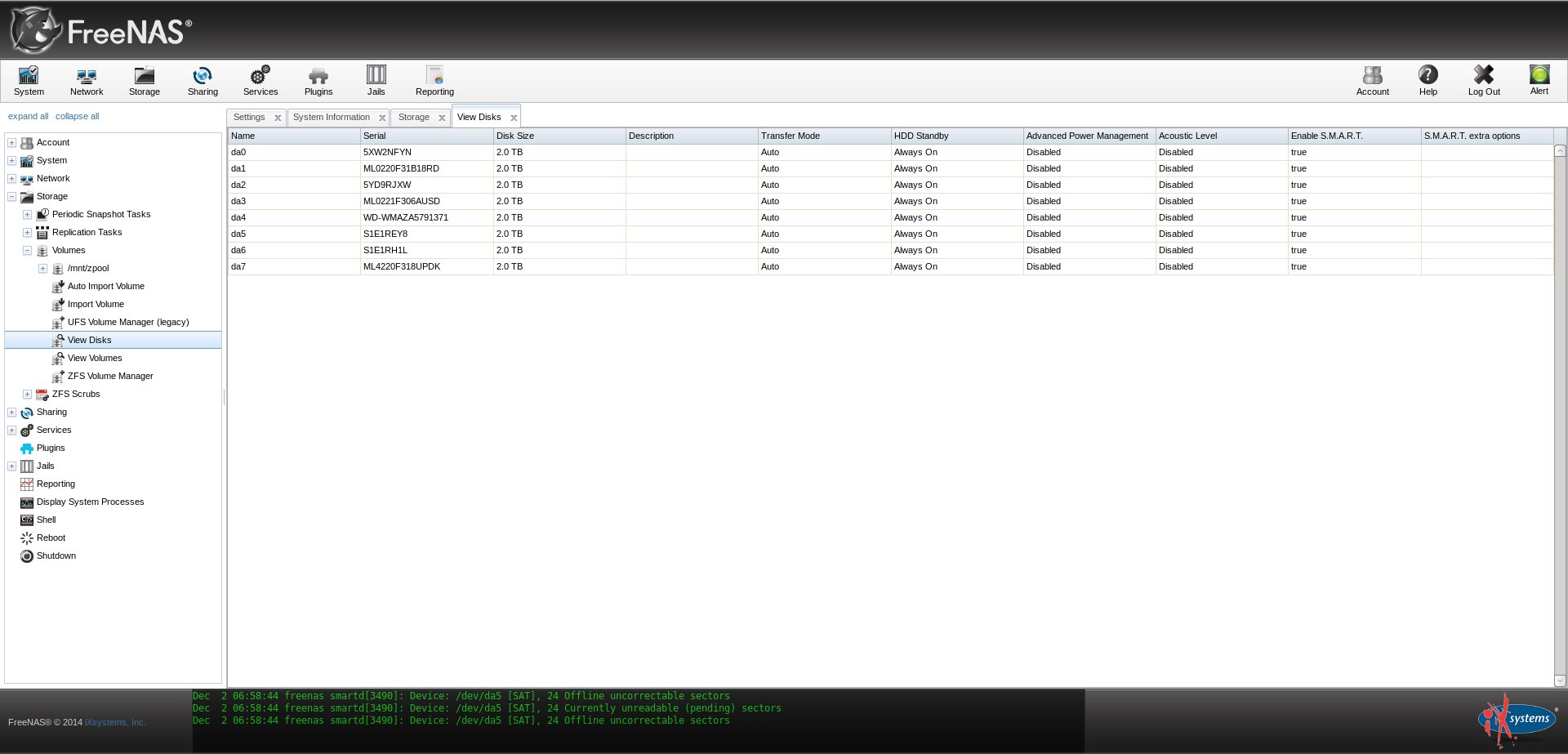

Hello,
I am currently using 8x 2TB (mixture of WD, Seagate & Hitachi) drives in a single RAID-Z3 pool (so 5 disks for data, 3 for parity). All these are installed in a Supermicro 16 bay enclosure and have plenty of memory and CPU power to handle the resulting 10TB vdev split in 4 datasets with compression enabled on all of them (except one).
While the read speeds are easily saturating a gigabit connection, I am having frequent pewrformance problems with writing or moving stuff in/out of the freenas server as I usually get around 7.5-10 MB/s which is tremendously low (IMO).
I believe this is due to the hard drives being of the green type (except the Hitachi's).
Just this morning one of the seagate Barracuda's started throwing unrecoverable sector errors (8 of them) which I believe is just the start. Right now the pool is being scrubed and I expect it completes within the next 30 hours..
I will order a replacement drive but in the meantime I am wondering how (and if I should at all) start over with the config and setup my drives differently.
Right now I see 3 options:
-Order a 2TB drive and replace the faulty one
-Order a 4TB drive, replace the faulty one and gradually (as the remaining 2TB's dies or if money allows) replace the remaining 2TB's with 4TBs. At the end expand the pool.
-Reconfigure everything using the remaining 7 2tb drives and a new 3-4TB drive..
My goals are in order of importance:
-Data integrity (over and above all others combined)
-Storage space (Over 10TB pool is good, 20+TB is too big I will never use all that space)
Write performance (my virtual machines are regularly backing files up and need some decent performance)
Read performance (This freenas server is used for media streaming and some other file reads but not so much)
I am seeking any advice, opinion, etc to help me make my mind..
Thanks!
EDIT: Important to mention, all 2TB drives were purchased around the same years and are all 4 years old) so I expect them to slowly die, especially the WD and seagate ones)

I think the issues are creeping...
Dec 1 18:57:03 freenas kernel: (da5:mps1:0:1:0): READ(10). CDB: 28 00 04 60 40 d8 00 00 08 00 length 4096 SMID 141 terminated ioc 804b scsi 0 state 0 xfer 0
Dec 1 18:57:03 freenas kernel: (da5:mps1:0:1:0): READ(10). CDB: 28 00 d8 f3 4d f8 00 00 08 00 length 4096 SMID 75 terminated ioc 804b scsi 0 state 0 xfer 0
Dec 1 18:57:03 freenas kernel: (da5:mps1:0:1:0): READ(10). CDB: 28 00 33 5a b5 a0 00 00 08 00 length 4096 SMID 208 terminated ioc 804b scsi 0 state 0 xfer 0
Dec 1 18:57:03 freenas kernel: (da5:mps1:0:1:0): READ(10). CDB: 28 00 b2 7c 43 98 00 00 38 00 length 28672 SMID 302 terminated ioc 804b scsi 0 state 0 xfer 0
Dec 1 18:57:03 freenas kernel: (da5:mps1:0:1:0): READ(10). CDB: 28 00 b2 7c 42 88 00 00 e0 00
Dec 1 18:57:03 freenas kernel: (da5:mps1:0:1:0): CAM status: SCSI Status Error
Dec 1 18:57:03 freenas kernel: (da5:mps1:0:1:0): SCSI status: Check Condition
Dec 1 18:57:03 freenas kernel: (da5:mps1:0:1:0): SCSI sense: MEDIUM ERROR asc:11,0 (Unrecovered read error)
Dec 1 18:57:03 freenas kernel: (da5:mps1:0:1:0): Info: 0xb27c4308
Dec 1 18:57:03 freenas kernel: (da5:mps1:0:1:0): Error 5, Unretryable error
Dec 1 18:58:44 freenas smartd[3490]: Device: /dev/da5 [SAT], 8 Currently unreadable (pending) sectors
Dec 1 18:58:44 freenas smartd[3490]: Device: /dev/da5 [SAT], 8 Offline uncorrectable sectors
Dec 1 18:58:44 freenas smartd[3490]: Device: /dev/da5 [SAT], ATA error count increased from 0 to 1
Dec 1 18:58:47 freenas smartd[3490]: Device: /dev/da5 [SAT], 8 Currently unreadable (pending) sectors
Dec 1 18:58:47 freenas smartd[3490]: Device: /dev/da5 [SAT], 8 Offline uncorrectable sectors
Dec 1 18:58:47 freenas smartd[3490]: Device: /dev/da5 [SAT], ATA error count increased from 0 to 1
Dec 1 19:04:50 freenas kernel: (da5:mps1:0:1:0): READ(10). CDB: 28 00 d6 8b d8 c8 00 00 38 00 length 28672 SMID 565 terminated ioc 804b scsi 0 state 0 xfer 0
Dec 1 19:04:50 freenas kernel: (da5:mps1:0:1:0): READ(10). CDB: 28 00 b2 96 a3 70 00 00 40 00
Dec 1 19:04:50 freenas kernel: (da5:mps1:0:1:0): CAM status: SCSI Status Error
Dec 1 19:04:50 freenas kernel: (da5:mps1:0:1:0): SCSI status: Check Condition
Dec 1 19:04:50 freenas kernel: (da5:mps1:0:1:0): SCSI sense: MEDIUM ERROR asc:11,0 (Unrecovered read error)
Dec 1 19:04:50 freenas kernel: (da5:mps1:0:1:0): Info: 0xb296a378
Dec 1 19:04:50 freenas kernel: (da5:mps1:0:1:0): Error 5, Unretryable error
Dec 1 19:05:22 freenas kernel: (da5:mps1:0:1:0): READ(10). CDB: 28 00 b2 96 e4 d0 00 00 08 00 length 4096 SMID 995 terminated ioc 804b scsi 0 state 0 xfer 0
Dec 1 19:05:22 freenas kernel: (da5:mps1:0:1:0): READ(10). CDB: 28 00 b2 96 e4 b8 00 00 30 00
Dec 1 19:05:22 freenas kernel: (da5:mps1:0:1:0): CAM status: SCSI Status Error
Dec 1 19:05:22 freenas kernel: (da5:mps1:0:1:0): SCSI status: Check Condition
Dec 1 19:05:22 freenas kernel: (da5:mps1:0:1:0): SCSI sense: MEDIUM ERROR asc:11,0 (Unrecovered read error)
Dec 1 19:05:22 freenas kernel: (da5:mps1:0:1:0): Info: 0xb296e4d8
Dec 1 19:05:22 freenas kernel: (da5:mps1:0:1:0): Error 5, Unretryable error
Dec 1 19:28:45 freenas smartd[3490]: Device: /dev/da5 [SAT], 24 Currently unreadable (pending) sectors (changed +16)
Dec 1 19:28:45 freenas smartd[3490]: Device: /dev/da5 [SAT], 24 Offline uncorrectable sectors (changed +16)
Dec 1 19:28:46 freenas smartd[3490]: Device: /dev/da5 [SAT], ATA error count increased from 1 to 3
Dec 1 19:28:46 freenas smartd[3490]: Device: /dev/da5 [SAT], 24 Currently unreadable (pending) sectors (changed +16)
Dec 1 19:28:46 freenas smartd[3490]: Device: /dev/da5 [SAT], 24 Offline uncorrectable sectors (changed +16)
Dec 1 19:47:02 freenas kernel: (da5:mps1:0:1:0): READ(10). CDB: 28 00 d3 48 96 58 00 00 e0 00 length 114688 SMID 627 terminated ioc 804b scsi 0 state 0 xfer 0
Dec 1 19:47:02 freenas kernel: (da5:mps1:0:1:0): READ(10). CDB: 28 00 d3 48 ab d0 00 00 20 00 length 16384 SMID 605 terminated ioc 804b scsi 0 state 0 xfer 0
Dec 1 19:47:02 freenas kernel: (da5:mps1:0:1:0): READ(10). CDB: 28 00 d3 48 ed b0 00 00 a0 00 length 81920 SMID 473 terminated ioc 804b scsi 0 state 0 xfer 0
Dec 1 19:47:02 freenas kernel: (da5:mps1:0:1:0): READ(10). CDB: 28 00 d3 48 97 38 00 00 e0 00 length 114688 SMID 136 terminated ioc 804b scsi 0 state 0 xfer 0
Dec 1 19:47:02 freenas kernel: (da5:mps1:0:1:0): READ(10). CDB: 28 00 d3 48 ab c8 00 00 08 00
Dec 1 19:47:02 freenas kernel: (da5:mps1:0:1:0): CAM status: SCSI Status Error
Dec 1 19:47:02 freenas kernel: (da5:mps1:0:1:0): SCSI status: Check Condition
Dec 1 19:47:02 freenas kernel: (da5:mps1:0:1:0): SCSI sense: MEDIUM ERROR asc:11,0 (Unrecovered read error)
Dec 1 19:47:02 freenas kernel: (da5:mps1:0:1:0): Info: 0xd348abc8
Dec 1 19:47:02 freenas kernel: (da5:mps1:0:1:0): Error 5, Unretryable error

freenas-supero
Jul 27, 2014
128
OK I will stop the scrub.
Right now a pool status gives:
[root@freenas] ~# zpool status
pool: zpool
state: ONLINE
scan: scrub in progress since Mon Dec 1 10:05:02 2014
3.78T scanned out of 10.7T at 93.5M/s, 21h41m to go
108K repaired, 35.18% done
config:
NAME STATE READ WRITE CKSUM
zpool ONLINE 0 0 0
raidz3-0 ONLINE 0 0 0
gptid/70057ca3-0fb8-11e4-9267-0030487f11ba ONLINE 0 0 0
gptid/7231ce76-0fb8-11e4-9267-0030487f11ba ONLINE 0 0 0
gptid/74010031-0fb8-11e4-9267-0030487f11ba ONLINE 0 0 0
gptid/74c45142-0fb8-11e4-9267-0030487f11ba ONLINE 0 0 0 (repairing)
gptid/7577d07e-0fb8-11e4-9267-0030487f11ba ONLINE 0 0 0
gptid/7799b692-0fb8-11e4-9267-0030487f11ba ONLINE 0 0 0
gptid/7979c1c6-0fb8-11e4-9267-0030487f11ba ONLINE 0 0 0
gptid/7ba4673f-0fb8-11e4-9267-0030487f11ba ONLINE 0 0 0
errors: No known data errors
I will replace the faulty da5 with a 3TB Seagate I have left around (brand new) and order a Hitachi 3TB as a spare...
I just hope the resilvering completes before the spare arrives from Newegg.... Good thing I am using raid Z3!
smartctl -a on da5 gives:

I am trying to find out the firmware version of the M1015's
EDIT: Is there a way to identify the da5 faulty disk without shutting down the freenas server and pulling each drive out of the caddies one by one? They have LED lights so if making da5 work would turn on the LED light I'd know which one it is....?? Is that possible?
solarisguy
Apr 4, 2014
1,125
In View Disks the first column is Name and the second is Serial. Write down the serial number from there, get a good magnifying glass and some light.
You may need to shutdown your system...
cyberjock
Inactive Account
Mar 25, 2012
19,525
You already provided the info on what drive it is...
[root@freenas] ~# smartctl -a /dev/da5
smartctl 6.2 2013-07-26 r3841 [FreeBSD 9.2-RELEASE-p9 amd64] (local build)
Copyright (C) 2002-13, Bruce Allen, Christian Franke, www.smartmontools.org
Model Family: Seagate Barracuda 7200.14 (AF)
Device Model: ST2000DM001-1CH164
Serial Number: S1E1REY8
LU WWN Device Id: 5 000c50 060fb47fd
9C1 Newbee
Oct 9, 2012
485
Yeah you are gonna have to get a look at the serial numbers to find S1E1REY8. It will be one of the Seagates :p
freenas-supero
Jul 27, 2014
128
OK here's a good one for you guys..
I have searched the web for a clear procedure on how to replace the dead drive (gracefully, not just pull the dead drive out and kick a replacement in..) but couldnt find any. Then I thought why not look at the Freenas handbook?
Section 6.3.12 of the handbook states :
Before physically removing the failed device, go to Storage → Volumes → View Volumes → Volume Status and locate the failed disk.
Storage → Volumes → View Volumes brings me to the datasets, not the disks. I assume where I need to go is "View Disks"... Then in that page (where I see all 8 drives), I do not see any "offline" or "replace" buttons.. Even if I highlight the da5 drive, all I get are a "edit" and "wipe" buttons.
So do I simply pull the defective drive out and swap it? Do I add a new drive first, then will Freenas understand that it is a replacement drive?
See the screenshot. I just dont want to wreck the pool, right now its still "Online" and green.... ;)
The screenshot doesnt show which FreeNAS version I use but it is "FreeNAS-9.2.1.6-RELEASE-x64 (ddd1e39)"
freenas-supero
Jul 27, 2014
128
Hmm OK for the errata but that doesn't explain why I cannot follow the manual to the letter...
As per my screenshot I provided, you see that I have no "replace", "offline" or "other" buttons, so clearly there is a discrepancy between the manual and the version of Freenas I run.
Tonight I will post a screenshot of the "View Volumes" page showing no such buttons as well... View Volumes shows my datasets, not the underlying disks.
EDIT: Based on my comments, would it be possible that the "Offline" or "Replace" buttons are not there because the disk has not failed yet? Technically it has not failed as it is still responding to freenas and has only bad sectors.. In that case can I pull the drive, then pop the replacement in and proceed with the instructions of the manual?
Im surprised nobody has encountered this scenario yet!?
rogerh
Apr 18, 2014
1,111
Have you actually clicked on one of the disks to select it? This mouse business is quite hard to get used to. But things happen when you actually select a given item.
You have to click on a disk for the buttons to show up, IIRC.
