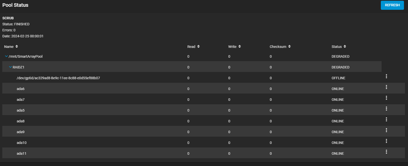

  7. But now the storage pool is degraded. It says "/dev/gptid/ac329ad8-8e9c-11ee-8c88-e0d55ef88b07" is offline. the 7 drives are showing as ONLINE. I'm not sure what this is. The replacement drive I didnt add to the storage pool?

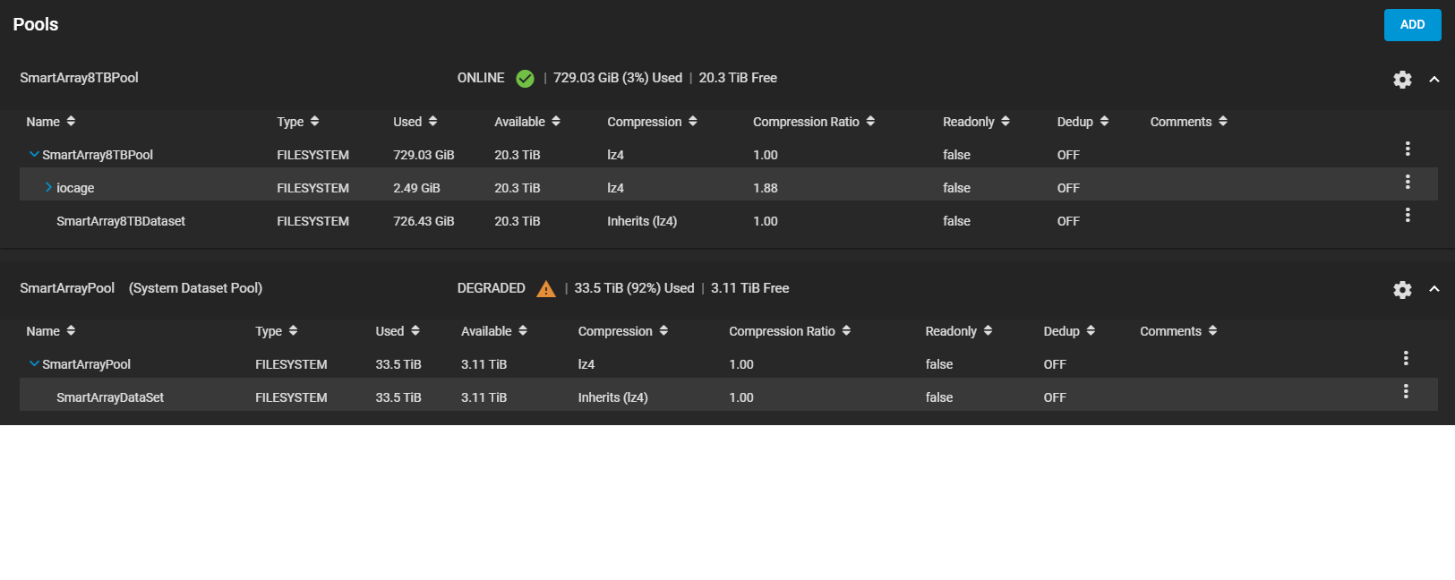

STORAGE POOL DETAIL
ZPOOL STATUS COMMAND RESULTS

pool: SmartArrayPool
state: DEGRADED
status: One or more devices has been taken offline by the administrator.
Sufficient replicas exist for the pool to continue functioning in a
degraded state.
action: Online the device using 'zpool online' or replace the device with
'zpool replace'.
scan: scrub repaired 16K in 08:36:42 with 0 errors on Sun Feb 25 08:36:43 2024
config:
NAME STATE READ WRITE CKSUM
SmartArrayPool DEGRADED 0 0 0
raidz1-0 DEGRADED 0 0 0
1548659058482393193 OFFLINE 0 0 0 was /dev/gptid/ac329ad8-8e9c-11ee-8c88-e0d55ef88b07
gptid/ac73245f-8e9c-11ee-8c88-e0d55ef88b07 ONLINE 0 0 0
gptid/ac3fb29e-8e9c-11ee-8c88-e0d55ef88b07 ONLINE 0 0 0
gptid/ac1e595d-8e9c-11ee-8c88-e0d55ef88b07 ONLINE 0 0 0
gptid/ac30999d-8e9c-11ee-8c88-e0d55ef88b07 ONLINE 0 0 0
gptid/ac0d89a6-8e9c-11ee-8c88-e0d55ef88b07 ONLINE 0 0 0
gptid/ac29e9c3-8e9c-11ee-8c88-e0d55ef88b07 ONLINE 0 0 0
gptid/ac7e5d25-8e9c-11ee-8c88-e0d55ef88b07 ONLINE 0 0 0
errors: No known data errors

I checked the documentation - did you mean this.. Replacement disk tutorial?
If so, I can take ada5 offline without data loss? I'm not sure what the '/dev/gptid/ac329ad8-8e9c-11ee-8c88-e0d55ef88b07' device is that is showing as OFFLINE and don't want to stuff it up.
I checked the 8TB pool it doesnt have one of these mystery devices.
I know I should back it up but I don't have a spare 30TB's lying around to back it all off too. I could backup some of it of course but not all.
Any advice on dealing with this mystery device BEFORE I take ada5 offline and replace it?
