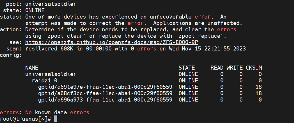

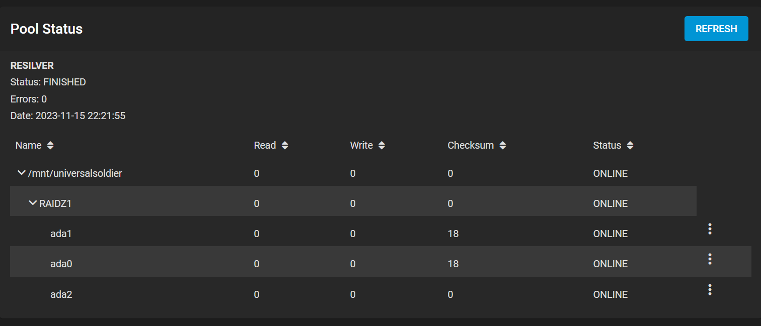

@Davvo question would be - why this timeout errors happening?:(command timeout errors.

I'm curious why it has seemingly stopped being an issue though.....that issue is not happening anymore.
