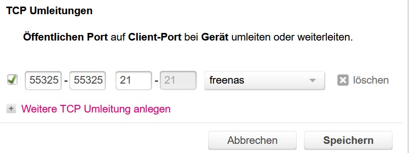

4. I configured an external port (TCP, not UDP) via my router (a Speedport W 724V from Deusche Telekom, it's manufactured by Sercomm) and redirected it to the FreeNAS, Port 21.

Are you forwarding port 21 to the correct internal IP? From the image in step 4 what is “freenas”, a hostname?

Freenas is the the NAS device in my home network. So the external port is 55325 and the internal port is 21 (at the NAS).

The firewall needs to know where to forward port 21 to, from step 4 can you change that to an internal IP of the FTP server?
So, the firewall receives a FTP request on port 55325 from the public internet which it will translate to port 21. It then needs to forward it onto host 192.168.1.5 (for example) on port 21

Step 4 refers to an internal IP - "freenas" stands for the internal IP of my NAS device ;-) - and it translate the ftp request on port 55325 to port 21 on the NAS device...

Is “freenas” then an “alias” for an IP or is it a hostname?
Can the firewall reach the FTP server?
