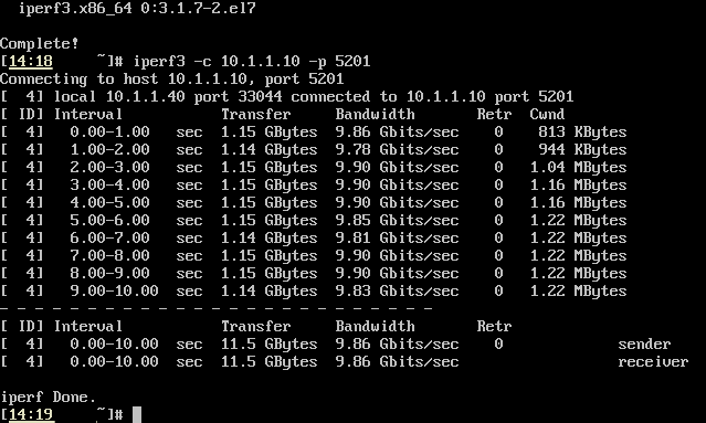

[Solved]
In case anyone is similarly curious in the future:
Testing on two intel hosts of differing hardware with intel and Broadcom 10Gbps Base-T NICs (on TrueNAS Core 13.0-U6.1) shows no appreciable slowdown in bridge mode:
XCP-ng Host 1:
XCP-ng Host 2:
Results are with each host running 1 VM at the same time (connecting to NFS Storage over same Storage network).
(MTU 9000)
These results were very pleasantly surprising.
