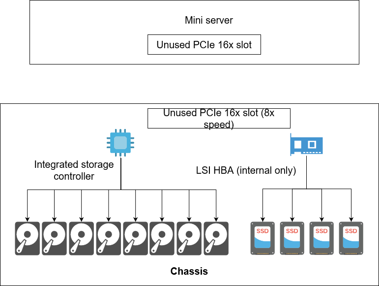

I want to export my TrueNAS LUNs over a dedicated connection to my mini server, and I want advice on the best way to do it. Both my TrueNAS box and my mini-server have empty PCI-E slots that I can use for some kind of expansion card.
The only way I can think to do this is over fiberchannel, using a couple of HBA cards from Ebay. However, as FC requires an enterprise license, this may be cost prohibitive. This setup is just for a home lab.
Would an external SAS card be appropriate for this purpose? I have no experience exporting LUNs over SAS, and have only been aware of its use in dasiy-chaining expansion bays to present more physical drives to a system.
My ultimate goal is to create a high-speed datapath between the NAS and the mini server that isn't dependent on the network.
