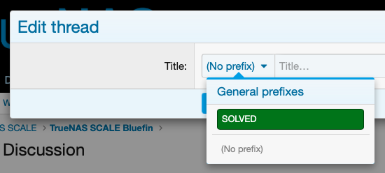

Can you please mark this thread as solved?
