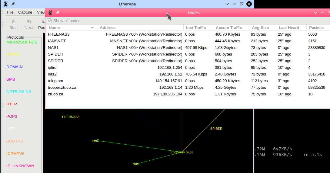

In recent times I've developed a problem with excessive network traffic between this box and my NAS boxes.
I have three FreeNas boxes (nas1, nas2, nas3), the first two are on 9.10 and nas3 on 9.3.
From a cold boot, the network will be quiet, then after some time (10-15 minutes) suddenly SMB will have a constant stream of traffic up and down to nas1 and/or nas2.
Screenshot below from EtherApe shows traffic overnight. I was asleep and not accessing the NAS, nor was anything else. Etherape says it is MS-DIRECTOR traffic.
The traffic runs for some time (tens of minutes or more) then just as suddenly stops for a while.

I tried looking with Wireshark but all I see is lots of small SYN and ACK packets, not sure how to see what is actually getting sent.
I installed ntop and drilled down, it claims the traffic is 100% SMB and 100% FTP (layer 7 traffic) which makes no sense to me at all.

Screenshot is also here: http://imgur.com/a/qvzXu

So you're seeing spikes in SMB traffic between a client and the NASs when there is no human using the client?
Without detailed protocol decodes it's impossible to know what's actually going on. I sincerely doubt it's anything on the NAS side.
Raw speculation: I'd look on the client for scheduled processes like indexing, virus scanning, touching the shared disks. Since the SMB mount isn't established after a reboot until the user logs in, this might explain what you're observing.
Aside from curiosity, is it really a big issue?
