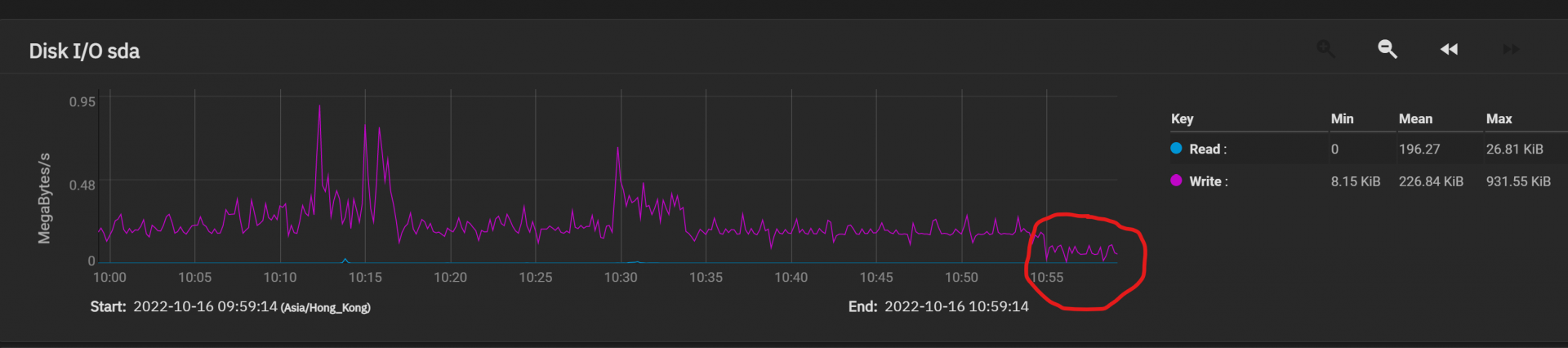

Hi All, hoping for a little help or guidance on this.
Issue:
Constant disk IO that has become quite noisy while the NAS should be idle.
It is typically in repetitive patterns that sound like retrying the same process over and over.
Occasionally the heads seem to be trying multiple functions at once and make a buzz that sounds like a beep and seems to culminate in what I guess is a head crash?
This is the repetitive pattern at present (not a sample of the head crash sound) - [Sample disk noise]
Previously:
Disks were fairly quiet unless there was some major activity, but even the initial re-silvering as I upgraded the array was pretty quiet.
Disks:
4x Seagate Ironwolf 8TB - ST8000VN004-2M2101 configured in RAIDZ2
Disk temps range between 34-38
SMART:
Drives are around 5291 hrs old with the last Extended Offline test completing error-free ~22hrs ago at the time of writing.
Daily Short tests were error-free as well.
smartctl shows the following (believe this is nothing to worry about?)-
High values in:
#1 Raw_read_error_rate
#195 Hardware_ECC_recovered
Zero values for:
#197 Current_Pending_Sector
#198 Offline_Uncorrectable
#199 UDMA_CRC_Error_Count
Last scrub completed 25 Sept 2022 (35day threshold) and found no issues.
Tried so far:
- checked served data - confirmed files were still usable and not getting encrypted by malware
- stopped all docker images - no change
- moved system dataset to the bootpool (mirrored SSD) - no change
- scoured logs - but nothing stands out to me as a novice
- reviewed htop - k3s server has a lot of processes, typically consuming the most CPU (<=15%)
- upgraded from 22.02.2.1 to 22.02.4 - found my zfs import to be comparatively slower than previous reboots and docker images failed to load without resetting config items
- reviewed general linux disk IO checks - found most recommend iotop, which is not installed (how do we install packages without causing dependency issues during later upgrades?)
- stopped k3s.service (sudo systemctl stop k3s.service) - IO did not stop but definitely reduced and had longer pauses between cycles
- started k3s.service - extra IO started again
- searched forums - few references to similar behaviour on old freenas versions, but not much for TrueNAS SCALE.
Below samples are obviously from 1 disk, but all 4 show very similar patterns.
Sample disk IO with k3s running:
Sample disk IO with k3s stopped:
Thanks in advance!

Minor update-
The 48hrs of constant grinding eased off. It now only happens periodically.
Interestingly, the disk IO seems fairly constant even without the loud disk activity.
So there are two behaviours -
- a baseline of writes, even while idling
- loud repetitive disk activity
I suspect there is some background task running that triggers this behaviour, most likely in zfs containers/workload.
Any suggestions for commands to run to confirm the cause?

I'm seeing very similar behaviour on a new Scale install, also with 8GB ST8000VN004-2M2101 driver (2 mirrored).
Similar story with searching solutions, tried shutting down all apps, moved dataset to bootpool SSD and shut down all shares with no change.
IO is mostly writes, few hundred KB written, then idle for a second or so and another write, idle, write...
Still a newbie to Truenas but happy to try any possible ideas

Looks like there is a container writing logs that look very much like debug mode has been left on.
cat ./ix-applications/docker/containers/b30320414bd87a576c9950e6a3a5f21c53fd2cf5ac508494e901bcc282fe5c11/b30320414bd87a576c9950e6a3a5f21c53fd2cf5ac508494e901bcc282fe5c11-json.log
........ {"log":"I1105 23:05:11.855305 1 leaderelection.go:273] successfully renewed lease kube-system/snapshot-controller-leader\n","stream":"stderr","time":"2022-11-05T23:05:11.855360631Z"}
{"log":"I1105 23:05:16.906802 1 leaderelection.go:273] successfully renewed lease kube-system/snapshot-controller-leader\n","stream":"stderr","time":"2022-11-05T23:05:16.906877661Z"}
{"log":"I1105 23:05:21.916918 1 leaderelection.go:273] successfully renewed lease kube-system/snapshot-controller-leader\n","stream":"stderr","time":"2022-11-05T23:05:21.916985748Z"} ....
lofgren
Dec 10, 2014
8
With my user containers all stopped, I am assumedly only left with system containers for zfs etc-
For the ix-applications/docker/containers logs, there are 5 -json.log files with very chatty, repetitive data:
Two separate logs capturing leaderelection.go:273 event every 5 seconds with occasional reflector.go:xxx entries
Another log capturing leaderelection.go:278 event every 5 seconds.
A fourth log with a cycle of zfsnode.go:100 / zfsnode.go:110 / zfsnode.go:114 / zfsnode.go:139 events every minute.
The fifth log noting No files matching import glob pattern every 30 seconds
Do these need to be so chatty? Is this debug/info level accidentally left engaged or is this necessary?

Researching some of the ix-container log entries led me to look again at the k3s_daemon.log
I see I am getting a lot of Trace entries, which some quick reading suggests might be caused by... high io
Nov 6 15:28:16 server_name k3s[3050120]: I1106 15:28:16.347394 3050120 trace.go:205] Trace[1650547161]: "Update" url:/apis/coordination.k8s.io/v1/namespaces/kube-system/leases/zfs-csi-openebs-io,user-agent:csi-provisioner/v0.0.0 (linux/amd64) kubernetes/$Format,audit-id:ed3f55c2-9799-4c61-9419-2432a4de3206,client:172.16.0.10,accept:application/json, */*,protocol:HTTP/2.0 (06-Nov-2022 15:28:15.784) (total time: 563ms):
Nov 6 15:28:16 server_name k3s[3050120]: Trace[1650547161]: ---"Object stored in database" 562ms (15:28:16.347)
Nov 6 15:28:16 server_name k3s[3050120]: Trace[1650547161]: [563.155203ms] [563.155203ms] END
Nov 6 15:28:16 server_name k3s[3050120]: I1106 15:28:16.417616 3050120 trace.go:205] Trace[1308440325]: "GuaranteedUpdate etcd3" type:*coordination.Lease (06-Nov-2022 15:28:15.784) (total time: 633ms):
Nov 6 15:28:16 server_name k3s[3050120]: Trace[1308440325]: ---"Transaction committed" 632ms (15:28:16.417)
Nov 6 15:28:16 server_name k3s[3050120]: Trace[1308440325]: [633.364397ms] [633.364397ms] END
Nov 6 15:28:16 server_name k3s[3050120]: I1106 15:28:16.417931 3050120 trace.go:205] Trace[1857111481]: "Update" url:/apis/coordination.k8s.io/v1/namespaces/kube-system/leases/external-resizer-zfs-csi-openebs-io,user-agent:csi-resizer/v0.0.0 (linux/amd64) kubernetes/$Format,audit-id:7824dc95-9bcf-4087-84c7-213812e1b780,client:172.16.0.10,accept:application/json, */*,protocol:HTTP/2.0 (06-Nov-2022 15:28:15.783) (total time: 633ms):
Nov 6 15:28:16 server_name k3s[3050120]: Trace[1857111481]: ---"Object stored in database" 633ms (15:28:16.417)
Nov 6 15:28:16 server_name k3s[3050120]: Trace[1857111481]: [633.872428ms] [633.872428ms] END
Nov 6 15:28:16 server_name k3s[3050120]: I1106 15:28:16.418509 3050120 trace.go:205] Trace[1376954379]: "GuaranteedUpdate etcd3" type:*coordination.Lease (06-Nov-2022 15:28:15.786) (total time: 632ms):
Nov 6 15:28:16 server_name k3s[3050120]: Trace[1376954379]: ---"Transaction committed" 632ms (15:28:16.418)
Nov 6 15:28:16 server_name k3s[3050120]: Trace[1376954379]: [632.419107ms] [632.419107ms] END
Nov 6 15:28:16 server_name k3s[3050120]: I1106 15:28:16.418850 3050120 trace.go:205] Trace[1359568093]: "Update" url:/apis/coordination.k8s.io/v1/namespaces/kube-system/leases/external-snapshotter-leader-zfs-csi-openebs-io,user-agent:csi-snapshotter/v0.0.0 (linux/amd64) kubernetes/$Format,audit-id:6d052cc0-13d7-4691-99f0-5a2a2deb7945,client:172.16.0.10,accept:application/json, */*,protocol:HTTP/2.0 (06-Nov-2022 15:28:15.785) (total time: 632ms):
Nov 6 15:28:16 server_name k3s[3050120]: Trace[1359568093]: ---"Object stored in database" 632ms (15:28:16.418)
Nov 6 15:28:16 server_name k3s[3050120]: Trace[1359568093]: [632.870281ms] [632.870281ms] END
Nov 6 15:28:16 server_name k3s[3050120]: I1106 15:28:16.517829 3050120 trace.go:205] Trace[401475017]: "GuaranteedUpdate etcd3" type:*coordination.Lease (06-Nov-2022 15:28:15.784) (total time: 733ms):
Nov 6 15:28:16 server_name k3s[3050120]: Trace[401475017]: ---"Transaction committed" 733ms (15:28:16.517)
Nov 6 15:28:16 server_name k3s[3050120]: Trace[401475017]: [733.511035ms] [733.511035ms] END
Nov 6 15:28:16 server_name k3s[3050120]: I1106 15:28:16.518238 3050120 trace.go:205] Trace[141335456]: "Update" url:/apis/coordination.k8s.io/v1/namespaces/kube-system/leases/snapshot-controller-leader,user-agent:snapshot-controller/v0.0.0 (linux/amd64) kubernetes/$Format,audit-id:e0866ce2-bfb8-44dd-8dd3-445a5374bd97,client:172.16.0.10,accept:application/json, */*,protocol:HTTP/2.0 (06-Nov-2022 15:28:15.784) (total time: 734ms):
Nov 6 15:28:16 server_name k3s[3050120]: Trace[141335456]: ---"Object stored in database" 733ms (15:28:16.517)
Nov 6 15:28:16 server_name k3s[3050120]: Trace[141335456]: [734.028185ms] [734.028185ms] END
The same file also contains a lot of spam with these:
k3s[3050120]: {"level":"warn","ts":"2022-11-06T15:25:29.183+0800","logger":"etcd-client","caller":"v3@v3.5.1-k3s1/retry_interceptor.go:62","msg":"retrying of unary invoker failed","target":"etcd-endpoints://0xc001a5c700/kine.sock","attempt":0,"error":"rpc error: code = Unknown desc = no such table: dbstat"}
Which apparently might need this setting added to a config somewhere - "SQLITE_ENABLE_DBSTAT_VTAB=1"
Reference: https://github.com/canonical/microk8s/issues/2965
