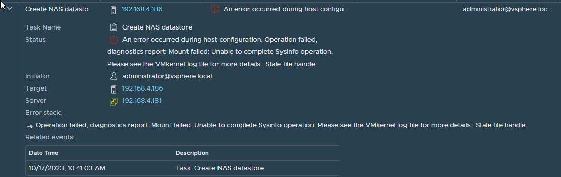

Now I'm trying to mount another datastore from a new dataset from a different IP subnet but I get an error with "stale file handle"...
As said, but that is weird as I already have 3 datastores running on TrueNAS... and that is a complete new dataset, no where else mounted

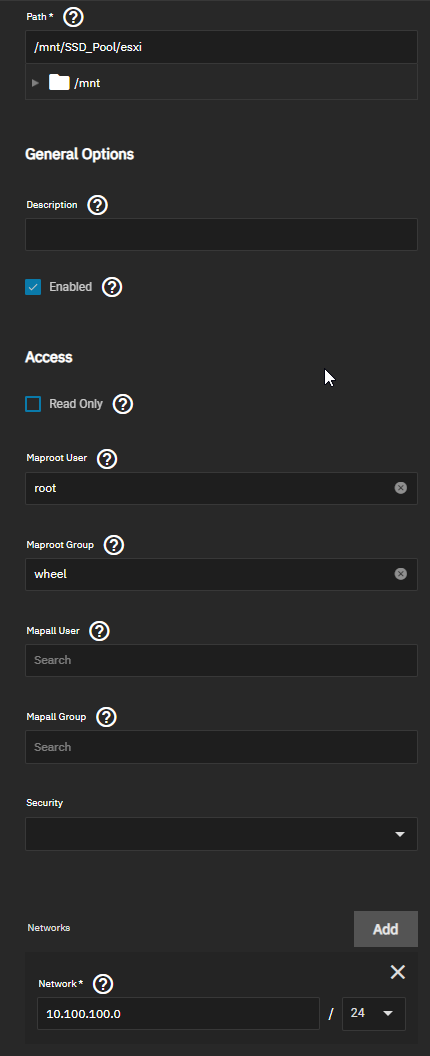

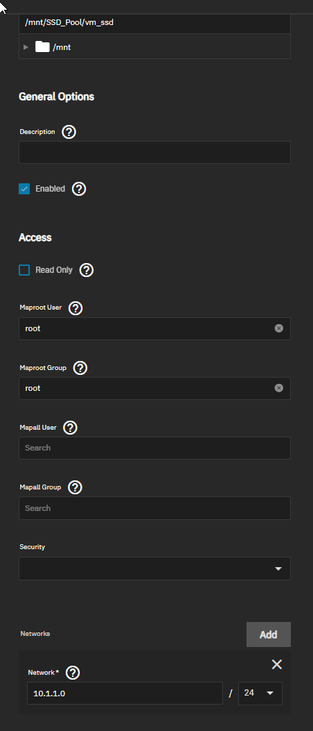

That is the share that is not working,

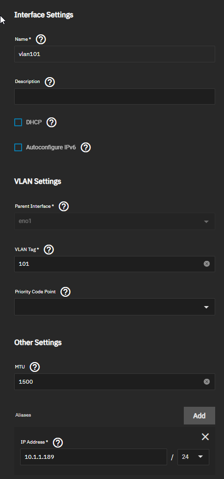

And that is a existing working dataset:
(do not wonder about the "networks", I use different ip addresses to mount that shares)
That is the network ports which is already working fine(that the onboard Intel I219 NIC):

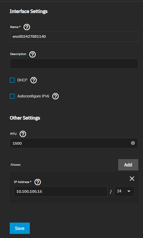

That's the network that is not working, well for NFS(USB Realtek 2,5G NIC):
Driver is fully and succesfully installed(it does not use the CDC_ethernet driver)
The ethernet port should not be the problem, I tried SMB access from a windows machine to that 10.100.100.15, and that works without a problem.
And I can ping that 10.100.100.15 interface from the ESXi without a problem.

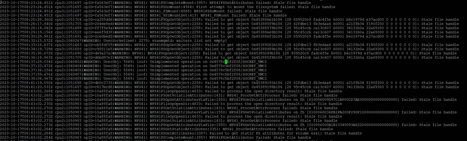

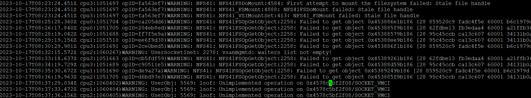

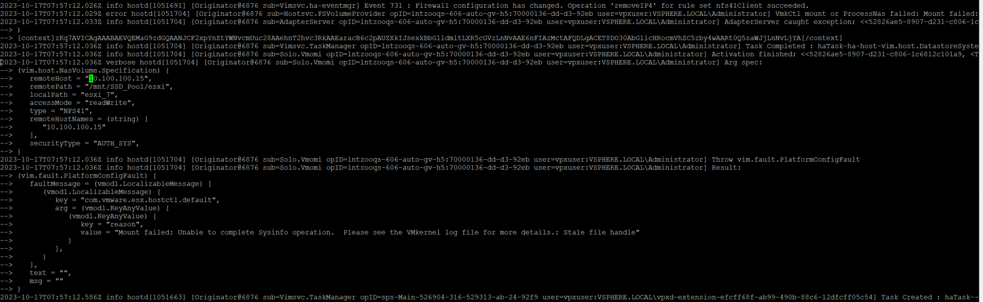

ESXi Log files are also not really helpful.

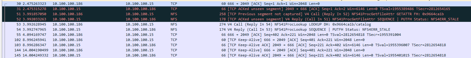

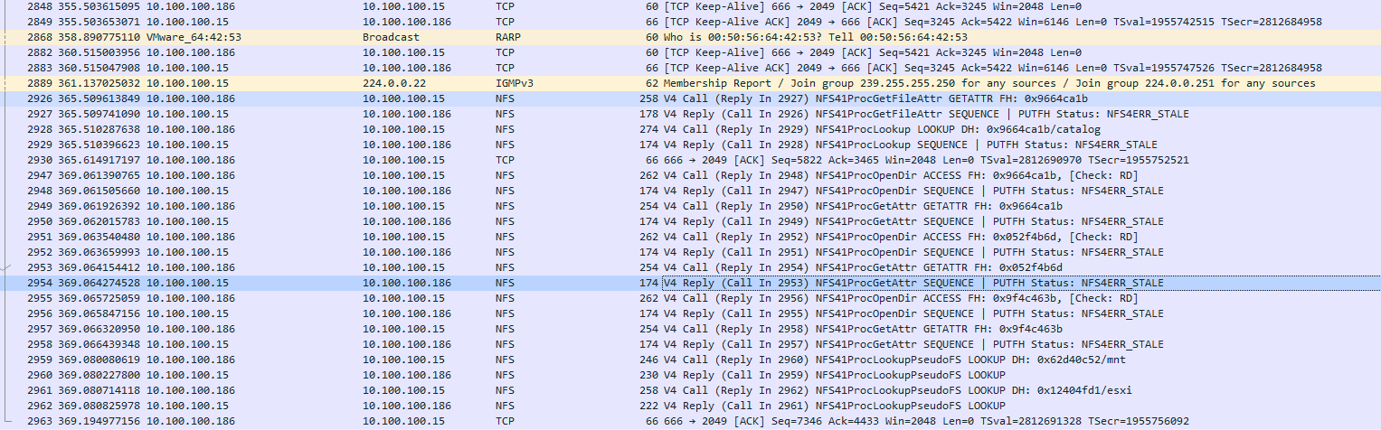

Maybe someone is more clever on analyzing TCP dumps than me, so I added some dump I did.
What is curious, one of the first lines(black):
Those black error only happen once, even if I try to mount the share multiple time within that TCP dump
besides that, I see that NFS stale also in those packets.
The filter I used is
(eth.src == 00:24:27:88:11:40) || (eth.src == 00:50:56:64:42:53) - 11:40 is the NAS, 42:53 is the ESXi host.
