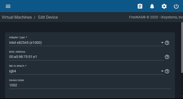

Oddly enough, shortly after posting this message and rebooting the VM, the VM now communicates via lagg0 thereby putting both services exactly opposite where I would like them. No configuration changes were made.
This is unexpected behavior since the nic is supposed to be attached to igb4 as originally setup, and still shows attached when editing devices.
After disconnecting the line to igb4, the plex jail reverted to communicating through lagg0 and the VM after rebooting communicates via lagg0 as well instead of getting no IP. Everything was setup using the GUI, Could this be a bug? Version: FreeNAS-11.3-U2.1
Thank you.
