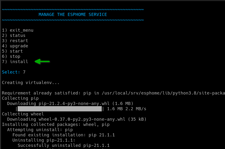

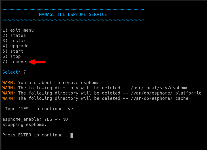

By now the updated requirements have made it to the plugin manifest for the 12.2-RELEASE, and I've also updated the plugin to use the toolchains I compiled. A clean install of the ESPHome plugin should (at least for now) compile both ESP8266 and ESP32 firmwares out of the box.
For an existing plugin, running a Plugin UPDATE from the TrueNAS UI should also work - but may require some additional steps. If the ESPHome service fails to start after a Plugin UPDATE, you'll need re-create the ESPHome virtualenv. This can easily be done from the jail's console menu.
Use number 7 to remove
When the virtualenv is removed, number 7 will change to install

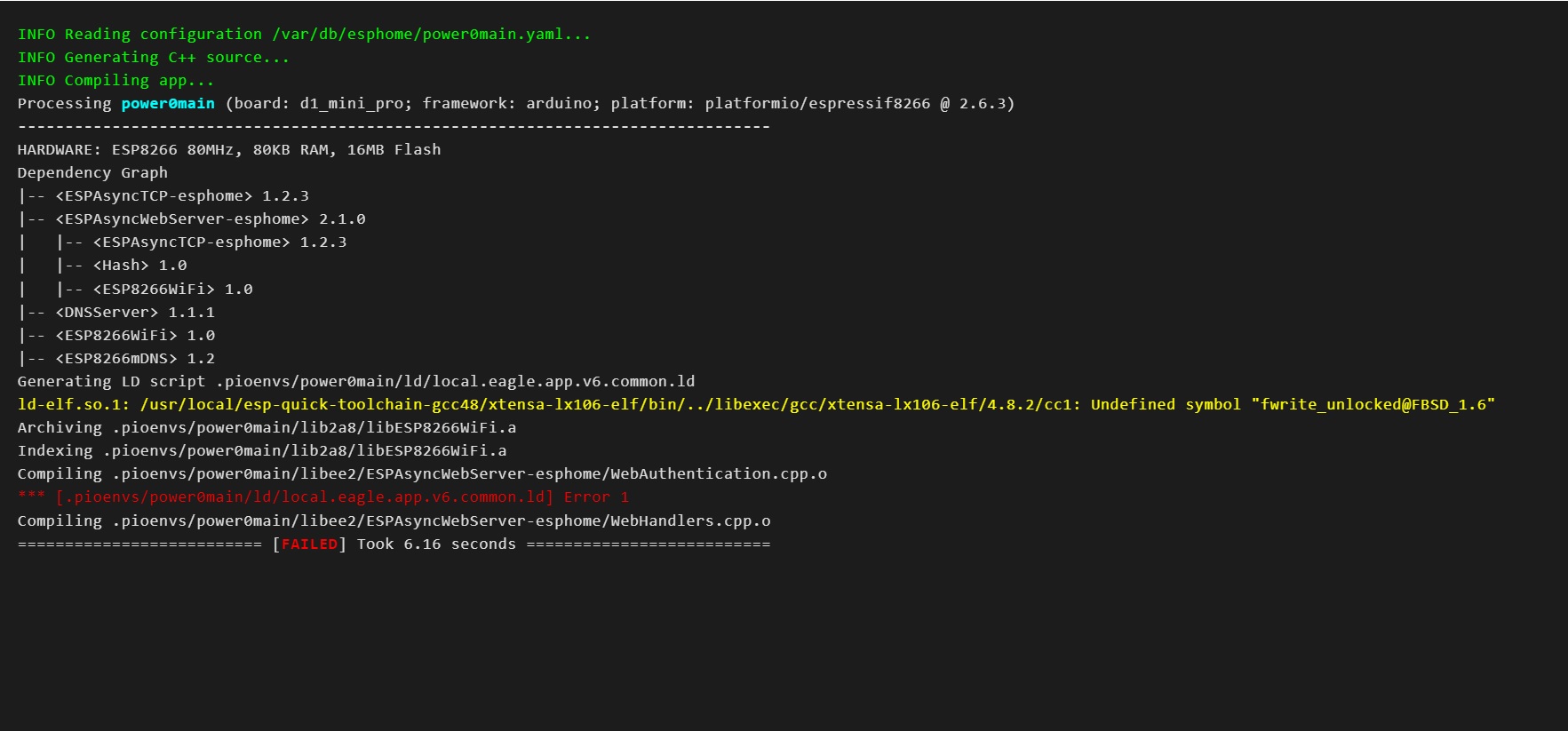

Mitaka
Dec 24, 2021
I have this problem with esp8266, esp32 works fine

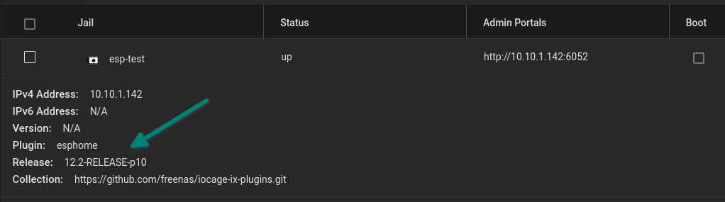

Hi @Mitaka - I need to stress, I'm really taking a guess here...
In my experience, these type of errors are typically caused by the jail using a FreeBSD release that is past EOL, or at very least needs updating.
Can you please say what TrueNAS version you have installed, and also what release your plugin is at?
I'm not running TrueNAS CORE atm, so best I can do is a quick test in a VM - I can confirm, at least on clean install, ESP8266 compiles without any errors. If your jail is not on the latest release, my best guess is that updating the jail would help.
