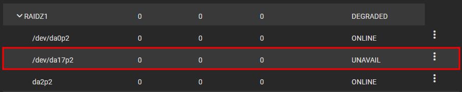

A drive fails in a raidz pool and the system outputs an alert letting know that it has to be replaced.
The failed hard disk is referred as UNAVAILABLE in the TrueNAS interface:

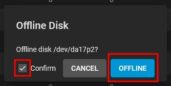

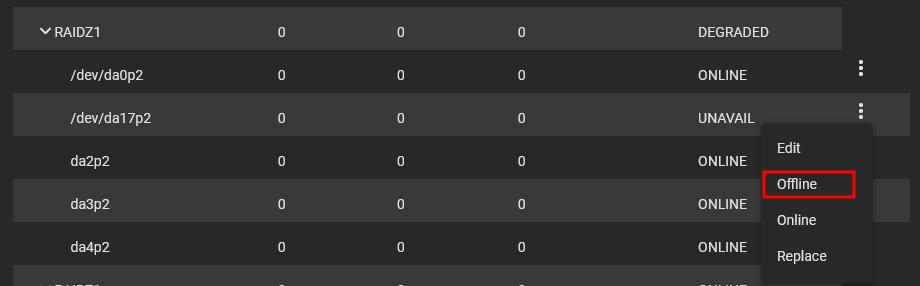

The failed hard disk is put offline using the menu and confirmed in the dialog that pops up:

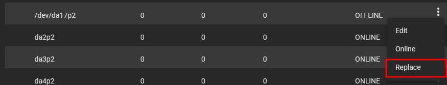

Finally, the reference to the failed disk is replaced in the pool's disks list:
The replacement process starts:

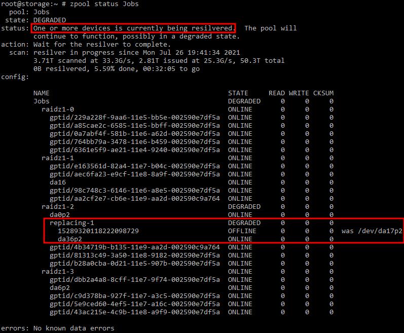

Although at this point it could seem that the whole disk replacement process has failed, the resilvering effectively gets started, as can be seen from the CLI with the zpool status mypool command:
At that point, the TrueNAS web interface does NOT report the silvering being in progress.
After a moment, reloading the TrueNAS web page shows that a resilvering is going on:
