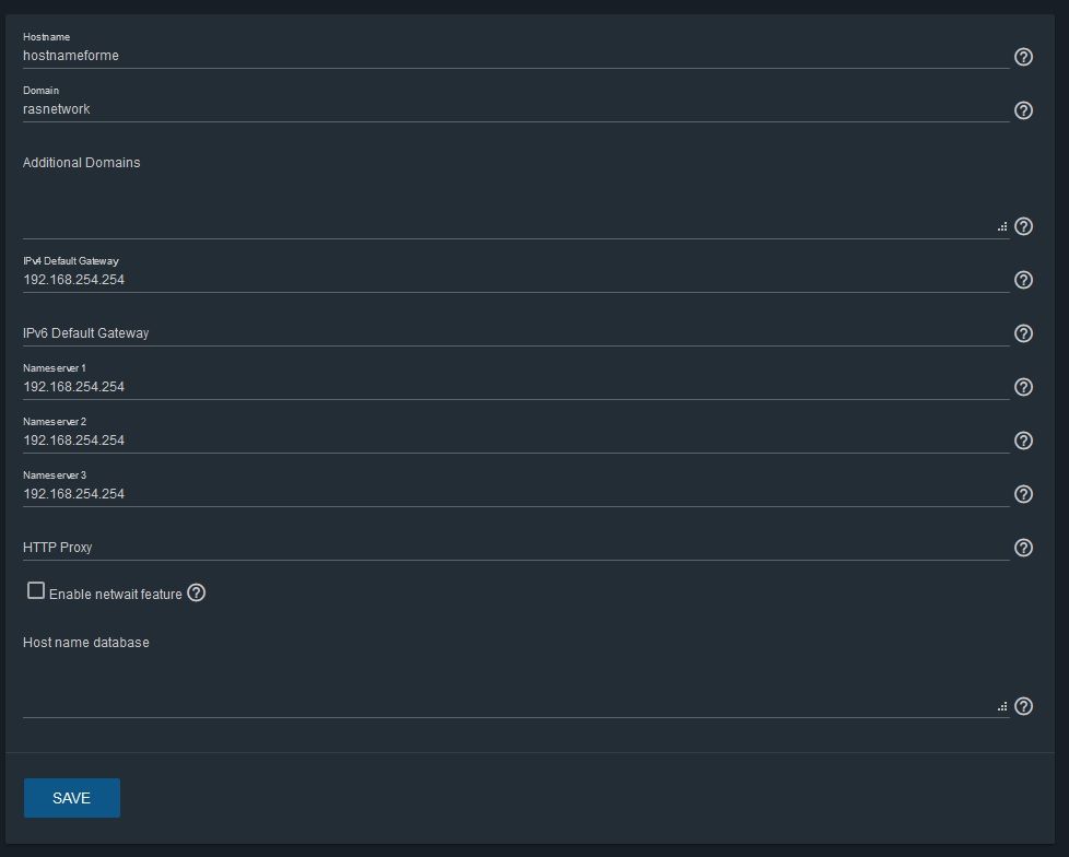

So either it didn't work or i put the info in the wrong spot, i entered all that info on the global config page, is that the right spot?

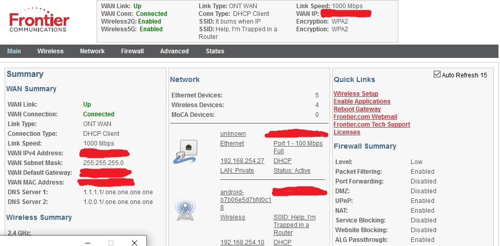

the .254 address is what i type in to access my router is that the address you meant? and i tried it with those blank with the addres in the pic, tried with 1.1.1.1, and i also tried them with the 8.8.8.8 that was suggested
as you can see on my router i have the 1.1.1.1 for my DNS
also the wan default gateway on my router and the wan IP on the router are slightly different as one is .01 and one is .33 is one of those addresses what i need to put somewhere?
the manual doesnt make sense as its more discriptions of stuff rather than what stuff does, as im a noob with networking. I can build computers all day but once its on it gets a bit tricky.

Looks like that should be right to me.
Take a look at this bug report and try the workaround there in the very last posting https://redmine.ixsystems.com/issues/58266 You'll need to create an account on Redmine if you haven't already done so.
BTW, DNS server 2 "doesn't look right" - numbers and text don't match(?). No clue if that impacts anything here, but probably not.
