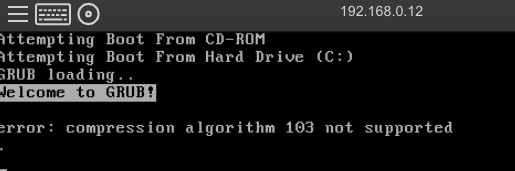

Anyone seen this yet? Updated to TrueNAS-SCALE-23.10.1.3.
Grub loading..
Welcome to GRUB!
error: compression algorithm 103 not supported
That's mostly noise, though it does seem to occasionally be a problem - but as long as your system boots, there's nothing to worry about. Just GRUB being GRUB, making people miserable.

Yeah, I should have mentioned - not booting....
I updated the first system to TrueNAS-SCALE-23.10.1.3 just fine, but the second one just hangs here.
So you drew the sort straw... It's weird because I keep seeing this with GRUB, apparently misreading snapshots? But then it ignores the errors?
The easiest solution is to reinstall. Before you nuke the boot device, do you have a backup of your config? You'll want that handy first - so we'll need to go fishing for it if you don't.
Alternatively, if you want to take matters into your own hands and despise GRUB, you could instead use ZFS Boot Menu, which has the considerable advantage of not requiring GRUB's byzantine configuration - just plop the executable down in the EFI System Partition, boot to it, and it should automagically find the TrueNAS install.

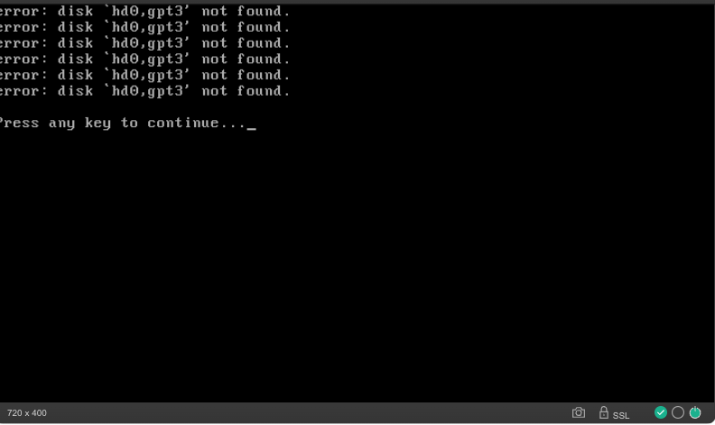

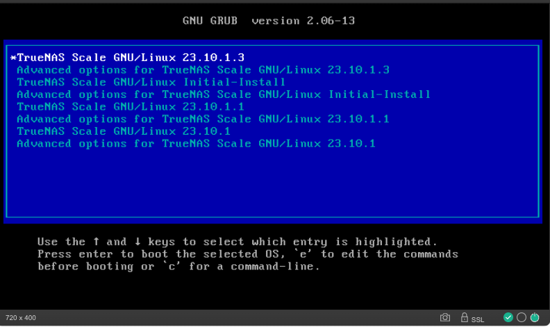

Was greeted to this on the remote-console this morning:
But then when I select anything, I get this:
Maybe I'll replace the boot disk and reinstall.
