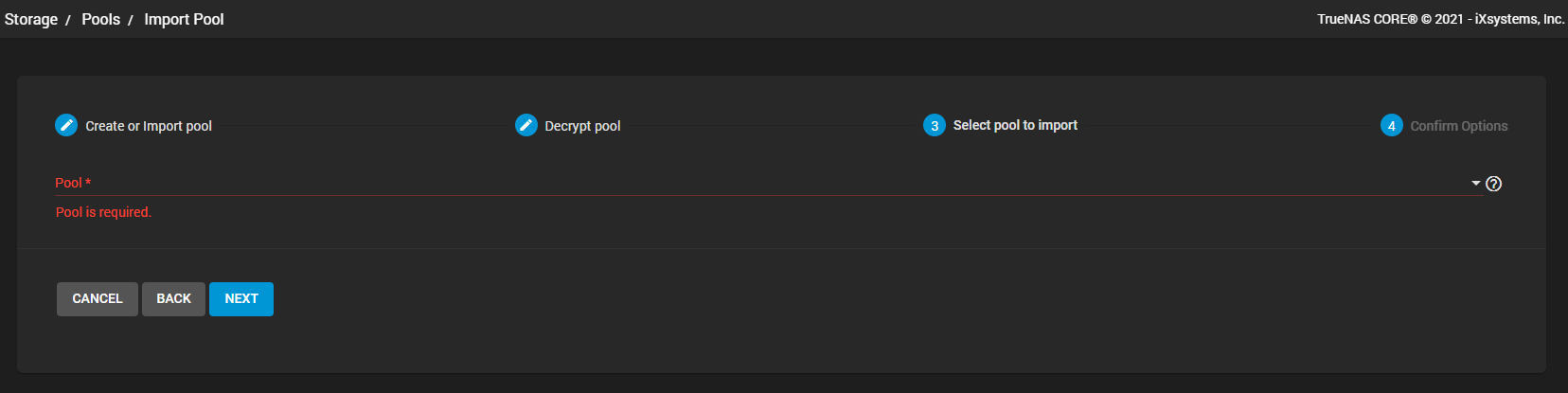

When attempting to import the pool that exists on the drive, nothing shows up.

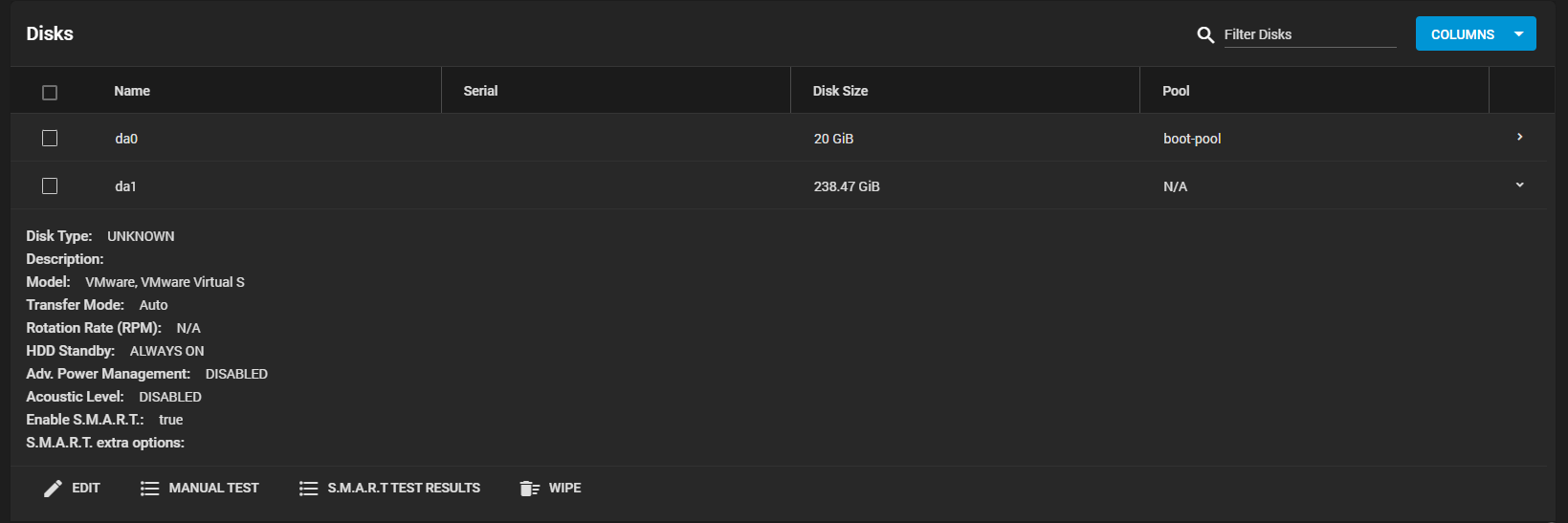

The disk does show up under Disks as da1:

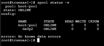

zpool status -v
output:
