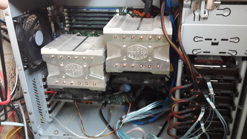

Familiar situation. :) Server board/CPUs plus huge heatpipe coolers is my recipe for good night sleep. :)
Chura
Apr 2, 2015
6
looks great.
why you have 2 heatsink ? dual cpu sockets ?
The board is ATX ?
mav@
Sep 29, 2011
1,428
There is old Supermicro X8DTH-6F dual-Xeon board. It is even bigger -- EATX, but I was able to find large desktop case that accommodated it. That is not only my home storage, but also my main day-job development server, so I have to combine power and queietness. :)
HoneyBadger
actually does care
Administrator
Feb 6, 2014
5,112
I like the franken-fitting of the Coolermasters (CM212 family?) but cover those rear slots and install some low-speed 120mm fans in the front to push air over your drives, right now they're in a dead airflow spot unless you've got something else going on.
mav@
Sep 29, 2011
1,428
There are two inflow 90mm low-speed fans just behind the drives and open grid before them. I would indeed better put single 120mm on the front panel, but that is a question to the case designer -- there is almost no openings in both front panel and HDD cage in that direction.
