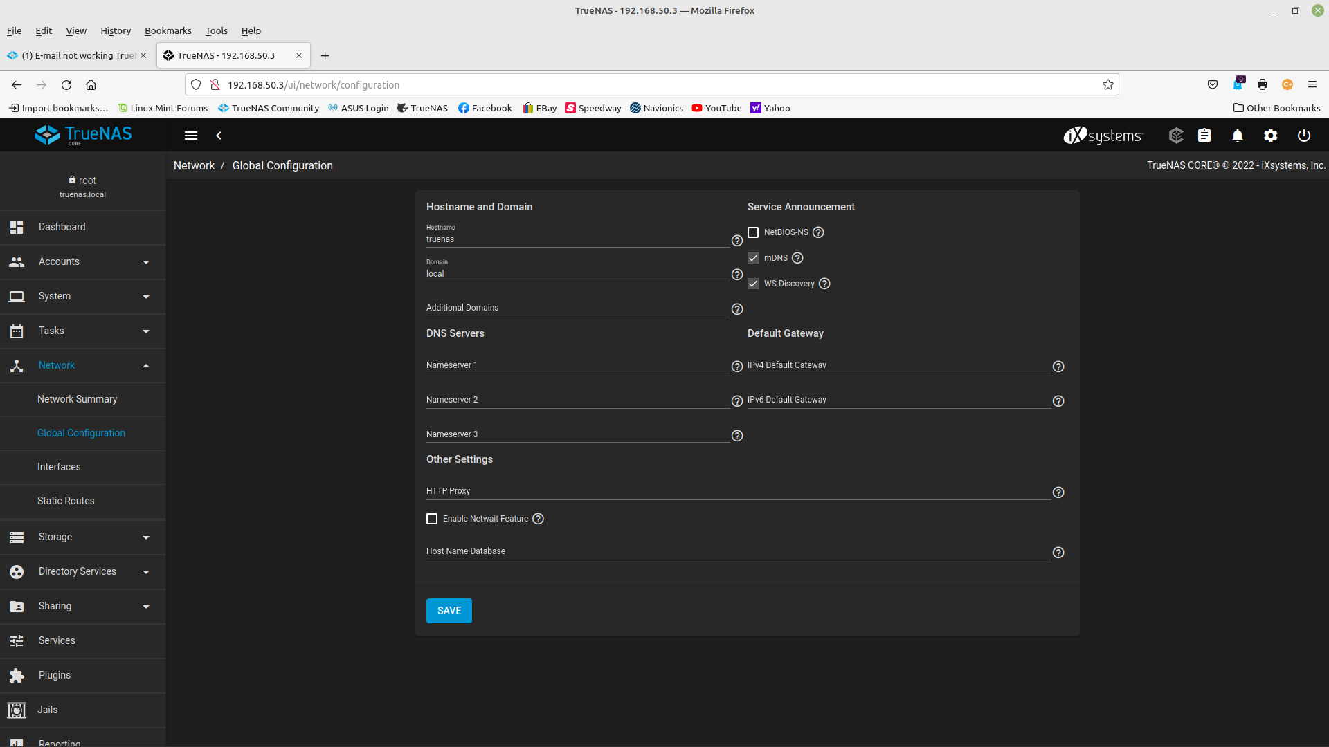

Totally new truenas user. I've followed the documentation on how to set it up but when I click the "Send Test E-mail"
button, I get this error message.
Error: [EFAULT] Failed to send email: [Errno 8] Name does not resolve
What am I doing wrong?

SnapTech

OK - You need to fill in your IPv4Default Gateway and DNS servers on the screen above.
Your default gateway is most likely the IP address of your router - maybe 192.168.50.1?
For DNS Nameservers - unless you know otherwise, use 8.8.8.8 for one, 8.8.4.4 for another.
Once you have made and saved those entries, TrueNAS should be able to get to the outside world. The other requirement to send the test email successfully is that you have entered a valid email address for the root user in Accounts/Users.

If you want to use a public DNS service you can typically do that from a central place in your router instead.
So a divergent opinion would be to use the IP address of your router as Nameserver 1 and let the router control DNS lookup instead of hardcoding 8.8.8.8 or something similar.
Yes, I have mine set up that way, but I’m uncertain if that always works…
neofusion
Apr 2, 2022
159
It doesn't always work, but then again what always works? :wink:
If the router breaks you're not going to reach 8.8.8.8 anyway, even if hardcoded on the appliance.
