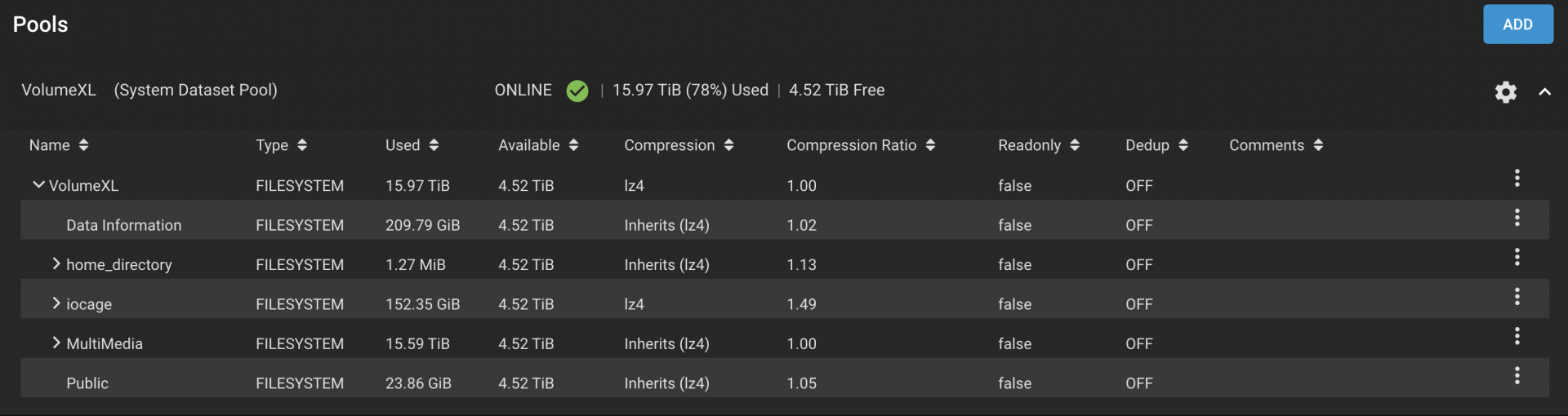

I thought that if I did a SnapShot of the DataSet top level that it would capture all of the necessary information needed such as the jails etc. So in my case in the image below if I SnapShot Volume XL DataSet then replicate that to the backup server that if I had the same config from Primary copied and imported to Backup (minus the IP address) then I would have an exact copy of the one server on the other.
Try it. Though I think the Replication Task might complain about how it "cannot overwrite the top-level root dataset" on the backup server.
Otherwise, it might "nest" VolumeXL under VolumeXL on the target, so that the pool layout on the backup server might look like so:
  • VolumeXL
    • VolumeXL
      • Data
      • home
      • iocage
      • multimedia
      • public
There are still configuration differences, which are housed in the "config file", that can be exported or found under the folder /data/, yet will not be touched / copied by any Replication Task.
