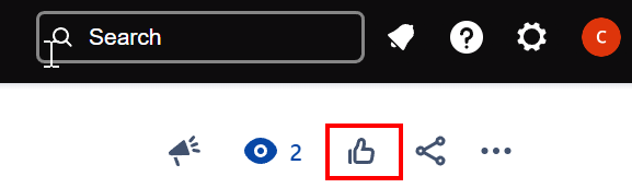

The Jira ticket shows this was done for SCALE, not CORE unfortunately. I added a new ticket to see about migrating to CORE as well. Vote for it by clicking the vote icon in upper right and maybe also leave a comment.
