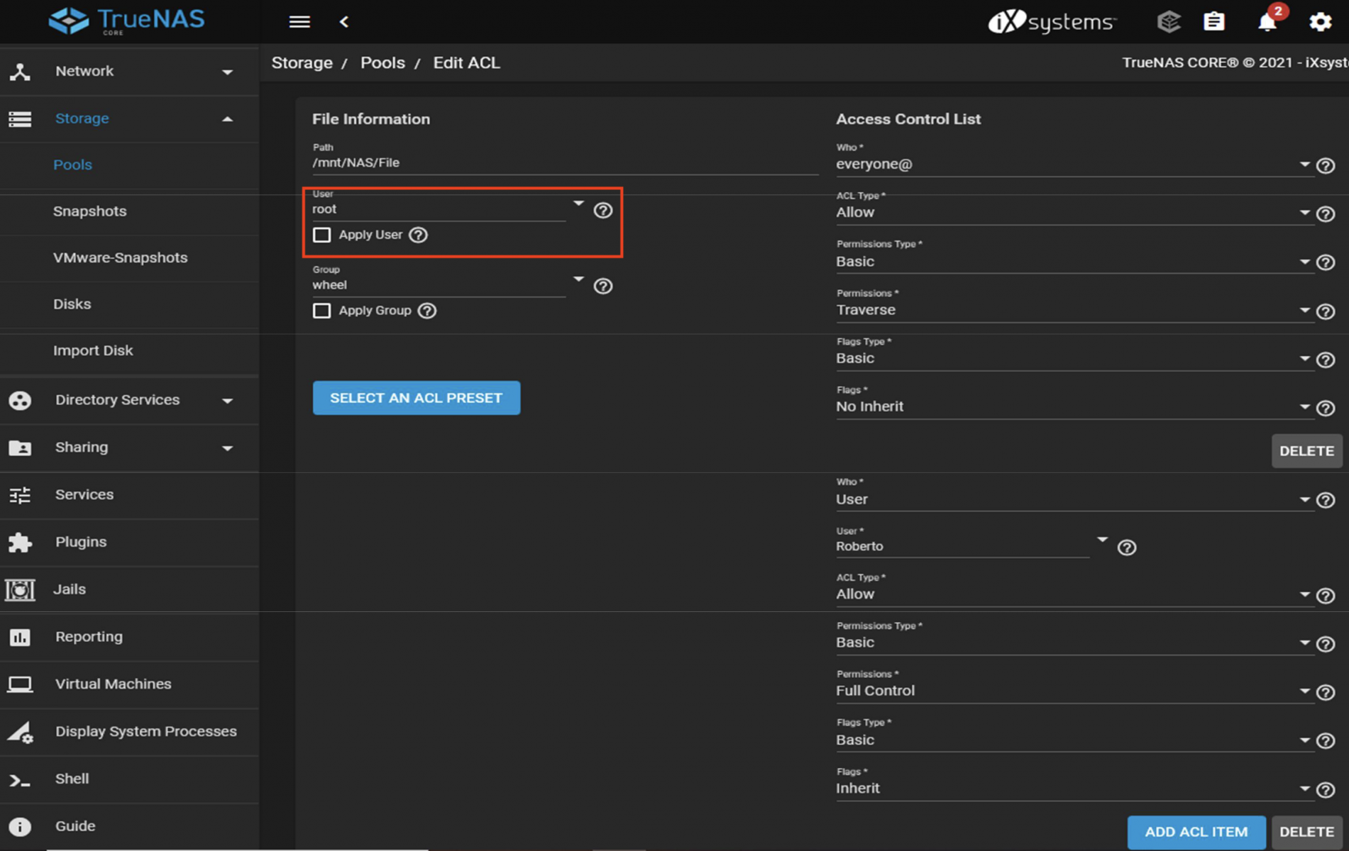

I removed the card and now I see both two discs. Now I have another problem. I have followed many tutorials of truenas, but when I try to add the created folder to network resources, by entering IP address and folder name, I cannot access it, as if the user is not recognized. I have activated SMB on the pc but I cannot see the folder. Could you please help me? Thank you Greetings

Could you share some screenshots of how you have configured your share?

9,700
OK, so from 6.pdf, we can see that you haven't made your user the owner.
You need to put your user there as the root user can't be the owner of a share.
You should also check the box to apply user after that.

Hi sretalla and thank again for your valuable help.
I've done what you suggested but i've again the same problem.
I don't know how to do
