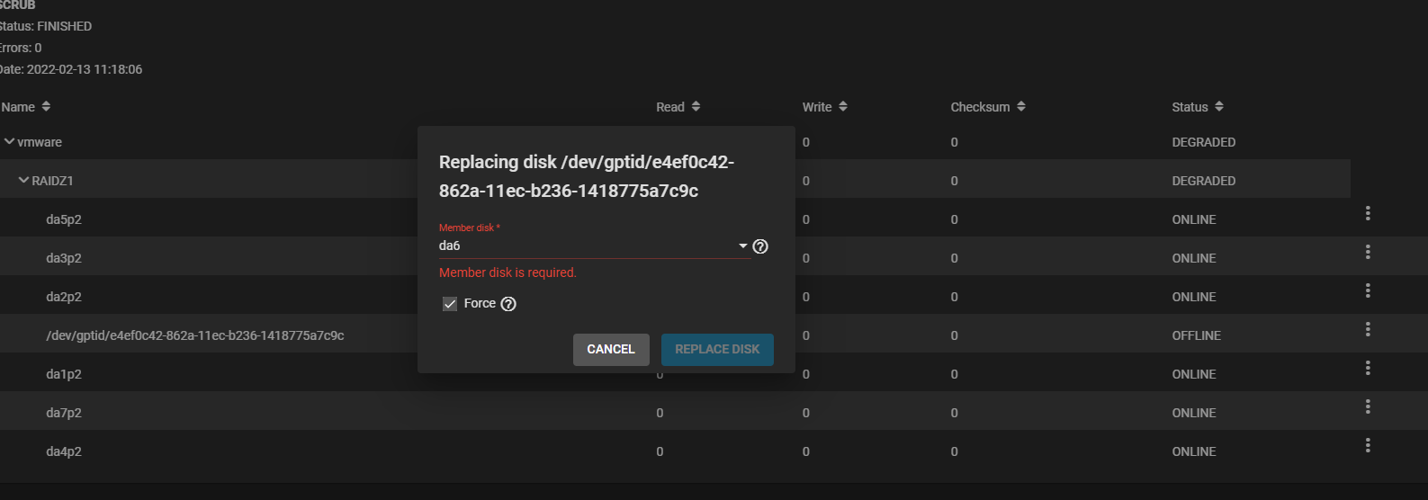

I am trying to replace a dead drive, however when I try to do this I keep getting "member disk required" even though I have selected the new disk. I am able to create a new pool with the disk I entered so the disk is visible to the system.

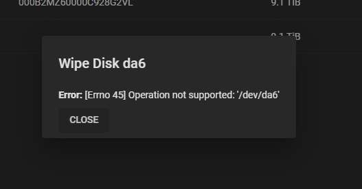

Do a Wipe on the new drive first.

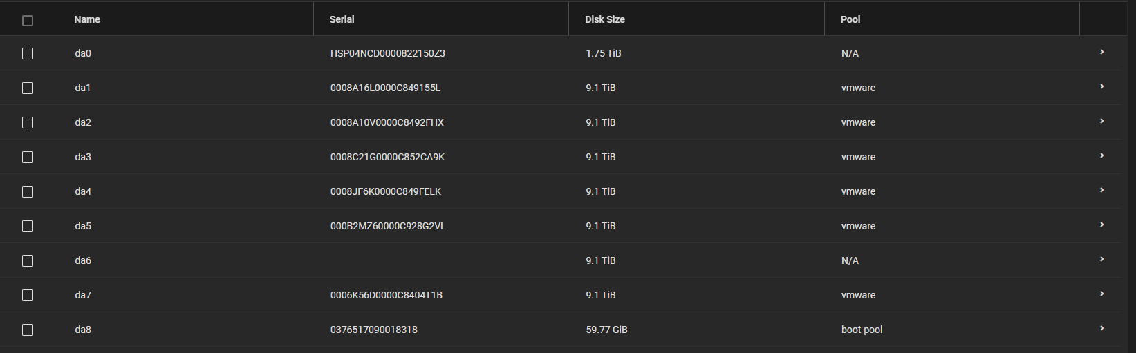

what does Storage - Disks look like ?
Alecmascot
Mar 18, 2014
1,177
what disk is da6 ?
Is truenas running baremetal?
How are the disks attached ?

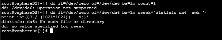

Try this in the CLI:
dd if=/dev/zero of=/dev/da6 bs=1m count=1
dd if=/dev/zero of=/dev/da6 bs=1m oseek=`diskinfo da6| awk '{print int($3 / (1024*1024)) - 4;}'`
