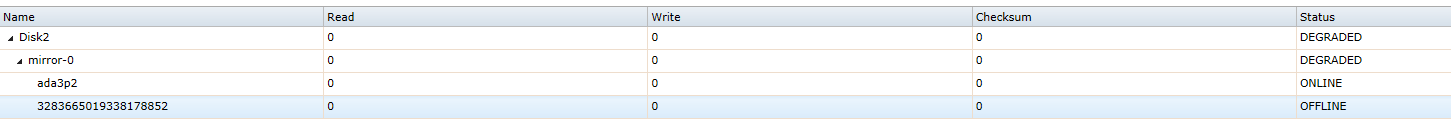

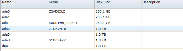

Hi, I am new here but have been using FreeNAS for about 4 years. This is the first time my mirrored drives have had a failure. After replacing my drive and restarting the box I see the new drive in my View Disk window (ada2).
Then when I look at the drive in the Volume Status window is comes up like below.
Then I click "replace" and select ada2 from the dropdown menu and press OK. I get the following message in the log.
Jul 30 17:31:51 Nas1 notifier: swapoff: /dev/ada2p1.eli: No such file or directory

Jul 30 17:31:52 Nas1 manage.py: [middleware.exceptions:38] [MiddlewareError: Disk replacement failed: "invalid vdev specification, use '-f' to override the following errors:, /dev/gptid/4db4f4d3-1839-11e4-b035-2c768aade61e is part of active pool 'Disk2', "]
Any ideas?
Thank you

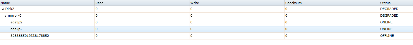

Well things are looking better now.... I have two drives online ada3 and ada2 the only problem is when I look at the details on ada2 its the old dead drives serial number

I was excited for about 2 minutes.... back to the same error as before. I get this when I do a replace disk
Jul 31 17:41:45 Nas1 notifier: swapoff: /dev/ada2p1.eli: No such file or directory
Jul 31 17:41:45 Nas1 notifier: geli: No such device: /dev/ada2p1.
Jul 31 17:41:45 Nas1 notifier: 1+0 records in
Jul 31 17:41:45 Nas1 notifier: 1+0 records out
Jul 31 17:41:45 Nas1 notifier: 1048576 bytes transferred in 0.007083 secs (148042497 bytes/sec)
Jul 31 17:41:45 Nas1 notifier: dd: /dev/ada2: short write on character device
Jul 31 17:41:45 Nas1 notifier: dd: /dev/ada2: end of device
Jul 31 17:41:45 Nas1 notifier: 5+0 records in
Jul 31 17:41:45 Nas1 notifier: 4+1 records out
Jul 31 17:41:45 Nas1 notifier: 4939776 bytes transferred in 0.067319 secs (73378461 bytes/sec)
Jul 31 17:41:46 Nas1 notifier: swapoff: /dev/ada2p1.eli: No such file or directory
Jul 31 17:41:46 Nas1 notifier: geli: No such device: /dev/ada2p1.
Jul 31 17:41:46 Nas1 manage.py: [middleware.exceptions:38] [MiddlewareError: Disk replacement failed: "invalid vdev specification, use '-f' to override the following errors:, /dev/gptid/d9ce770e-1903-11e4-bafa-2c768aade61e is part of active pool 'Disk2', "]
