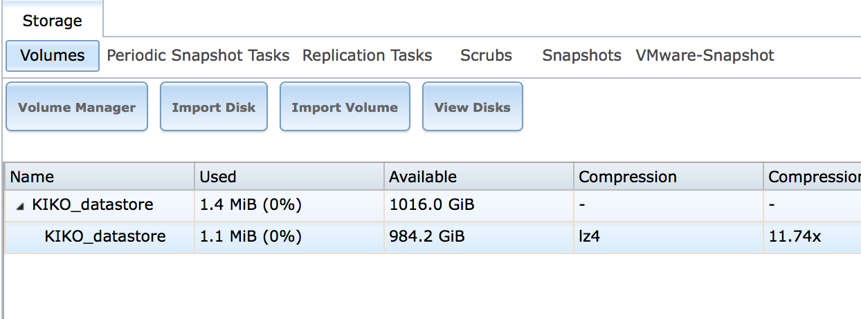

I have attached a screenshot of my "Volumes" tab, showing my single KIKO_datastore volume, and my KIKO_datastore dataset underneath. This is the dataset that it will not allow me to delete, I assume because the system dataset is on it. I thought I would then try to create another dataset under the volume in parallel with the "KIKO_datastore" dataset but I cannot do this. Is there always a hierarchy of {volume name} then {first dataset with matching name as volume} and then underneath of that dataset is where the admin has the ability to create their own datasets? I think having a firm understanding of this is where my disconnect is.

Dec 2, 2015
730
System dataset - I had that issue too. You'll need to move it somewhere else. Either to the boot volume (OK if you have a boot SSD, but not recommended if you are using USB flash sticks), or to a dataset that will not be overwritten by this replication.
