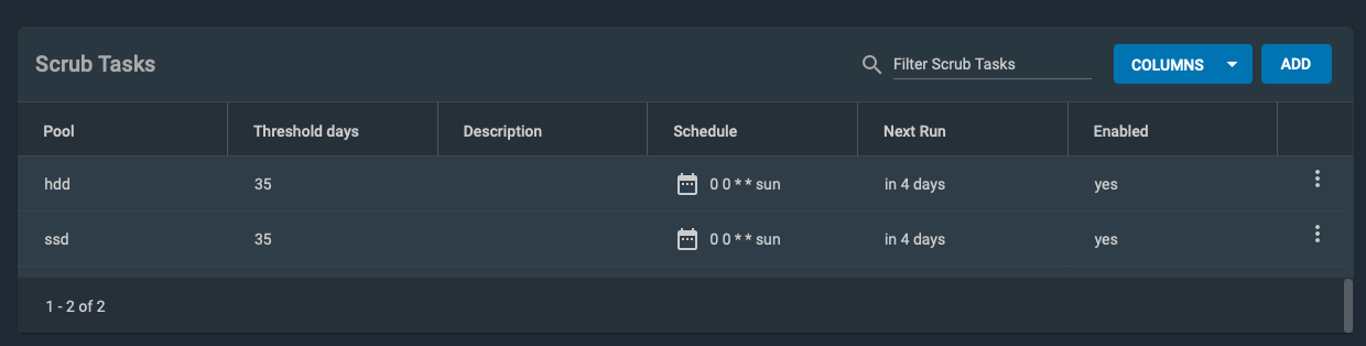

Thank you everyone for your responses! Are the maintenance items for the NAS to check for corrupted blocks and correct them manual or automatic?
Patrick M. Hausen
Nov 25, 2013
7,776
There are regular "scrub" tasks that do exactly that.
