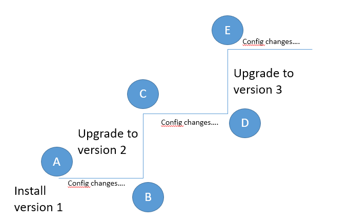

I think the confusing part is thinking of the boot environments as snapshots, and trying to identify when a snapshot is taken, and what the data looks like at that time.
Are Boot Environments just snapshots? If yes, then when are they taken, if no, then what are they?
For example (see diagram below), I thought of them as snapshots, and when upgrading from version 1 to 2, I would have thought that a snapshot called "Version 1" was created at point B (and the user guide seems to support this - "5.3. Boot Beginning with version 9.3, FreeNAS® supports a feature of ZFS known as multiple boot environments. With multiple boot environments, the process of updating the operating system becomes a low-risk operation as the updater automatically creates a snapshot of your current boot environment and adds it to the boot menu before applying the update. If the update fails, simply reboot the system and select the previous boot environment from the boot menu to instruct the system to go back to that system state.")"
What I kinda thought I heard above was that the "Version 2" snapshot was created at point C. And that is where my confusion came in.
