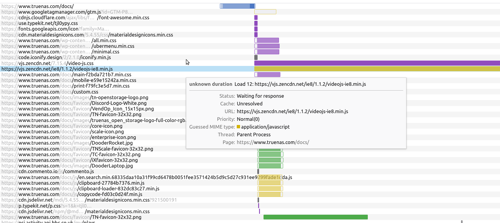

OK looked a bit further at this as I noticed when going to https://www.truenas.com/docs/ I saw "connecting to vjs.zencdn.net" flashing up.
nslookup does resolve.
vjs.zencdn.net canonical name = dualstack.osff.map.fastly.net.
Address: 199.232.58.217
Address: 2a04:4e42:4b::729
after a while 40 seconds + the page does show up.
Nothing showing up as being blocked at the firewall while this is waiting.

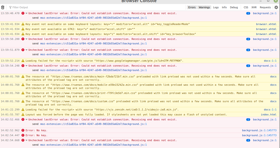

Is it just me that see this issue?
