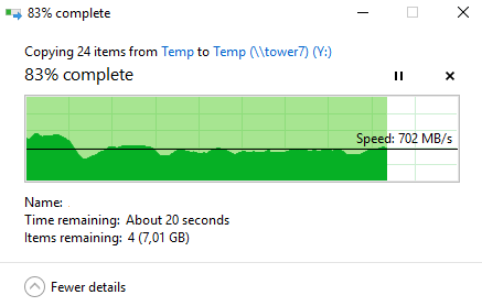

This is what I get with mine:
Pretty happy with it, especially considering the cost.
