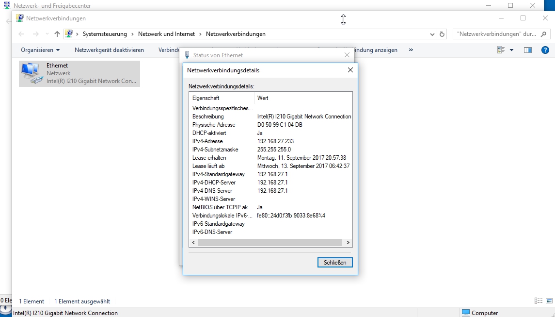

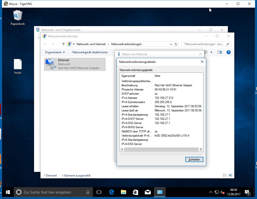

thanks for explaining that. That helps. However I thought this is automatically done by the DNS which sits inside the router. My understanding is that each of the clients in the network receives the necessary data by the Router. By DHCP it gets the Ip-Adress the Gateway and also the Nameserver. When I look into the details of the network configuration of the VM this data is present (see Screenshot 1). It is pretty much the same than on another (NON-VM) Windows 10 client in the Network (see Screenshot 2). I never had any problems within my network. Each client could reach the server by name or IP except the VM.
So my question is more...Why does the name resolution work for every client in the network without editing any host file but on the VM it does not. And even that is a bit strange because on the VM it works for all other connections except to the host. If that is the "normal" behavior because of VM-Host I am fine but if not I want to understand to avoid any problems in the network.
